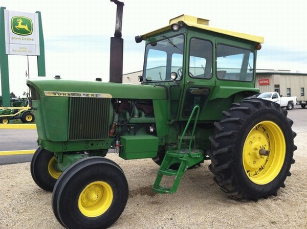

A 4520 will pull it. 1972 model that is :)
