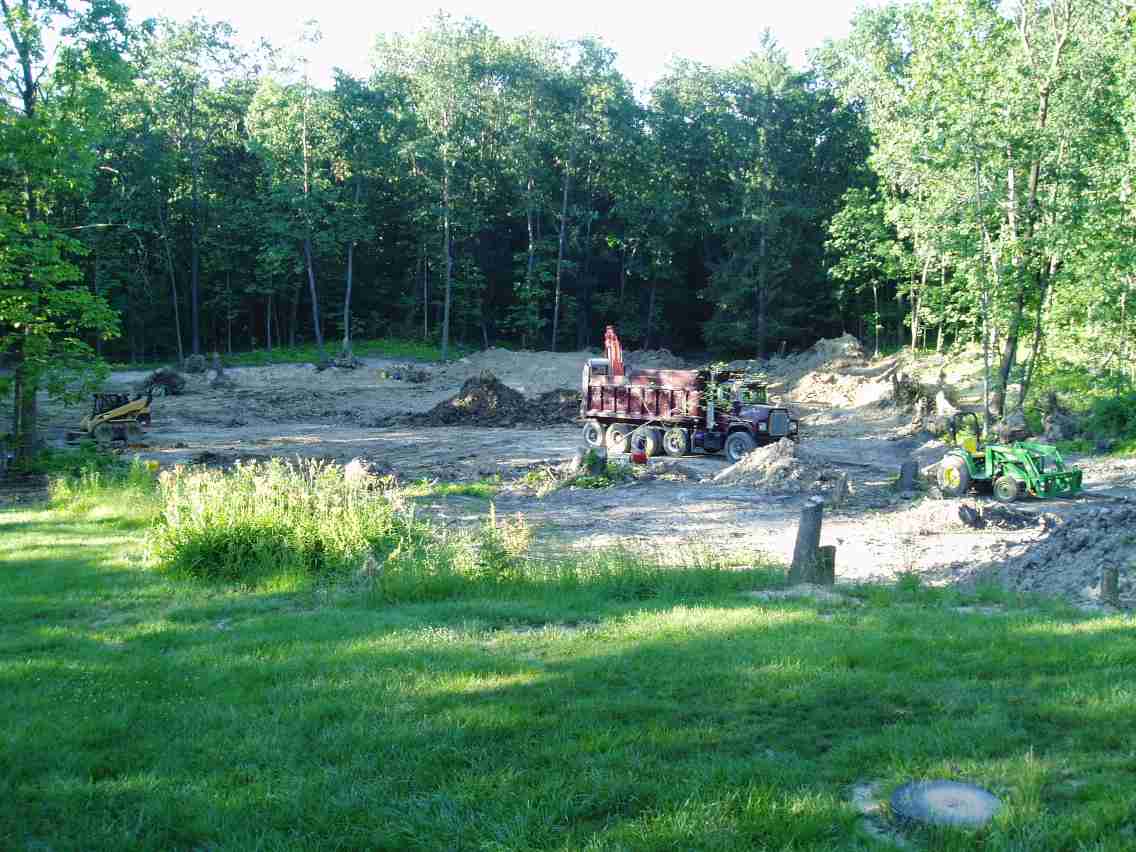

I had a similar train of thought when I bought my BX23 - my initial projects were to dig out for a 100ft extension to my driveway and then to dig a foundation hole for a new 3 car garage. I have a small lot - just 1/2 acre - so I did not want to get too large of a tractor. Well - I got the driveway dug out - and I am in the process of digging out the foundation hole now (see attached picture), but I have to say I sure do wish now that I got a bigger tractor, or bought a BX with FEL and then a used excavator or some other combo. Don't get me wrong - the BX does get the work done, but digging out the driveway took me months and the foundation hole is also taking a good amount of time. I am up to 250+ hours on the tractor now.

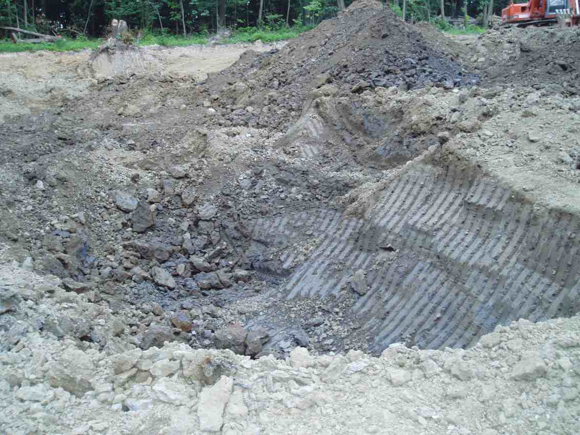

In order to have fish in a pond around me in Indiana 50 percent must be 10 feet deep. In this picture I am down to about 16 below my max waterline. You can see the grey clay. A CAT 262 skidsteer with steel tracks that weighs about 9000 lbs couldn't do a thing in it. A hitachi EX150 excavator that weighs about 30,000 lbs is what I used to dig with.

let me try again
   / Can 3720 dig pond in clay??? #10
This is what I am using on my 3/4 acre pond. I had to put my deere in for this forum. Forks and box blade
