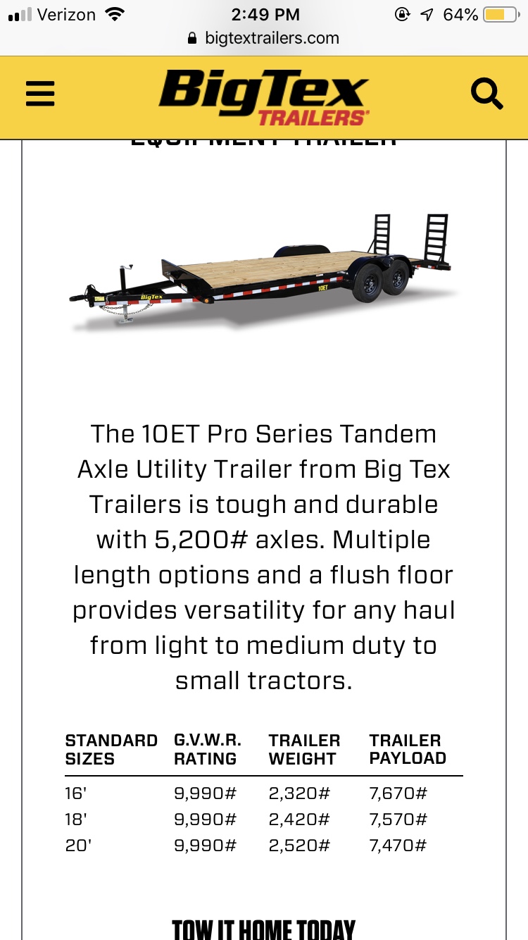

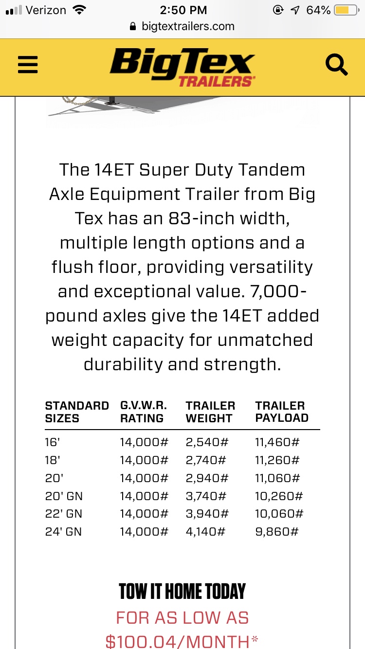

Something like this is about the minimum trailer required to haul it. Personally I’d go for a 14k that’s about 400 pounds heavier for the 20’ length. Usually tow ratings are “up to” which fluctuates greatly depending on the actual setup. You’d be at the maximum rating at the 9,000 pound mark. IMG_8412.JPGIMG_8413.JPG
