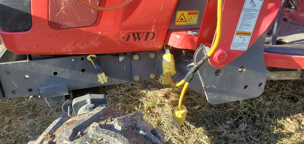

   / Can’t find a block heater for my 1739E (2020) #17
Great minds think alike!
But north of Montreal is colder and in a snow belt.
I also have an 'intelligent maintainer' plugged in 24/24 (as I also do on my standby generator*).
Cheap insurance in my opinion.
*We are at the end of a power grid and experience all too many outages.
Otherwise we are in paradise and would not wish to move.
I built a 2 outlet pigtail you can see tender plugged in and heater unplugged. I also use end covers on the 2 items to protect plugs.
