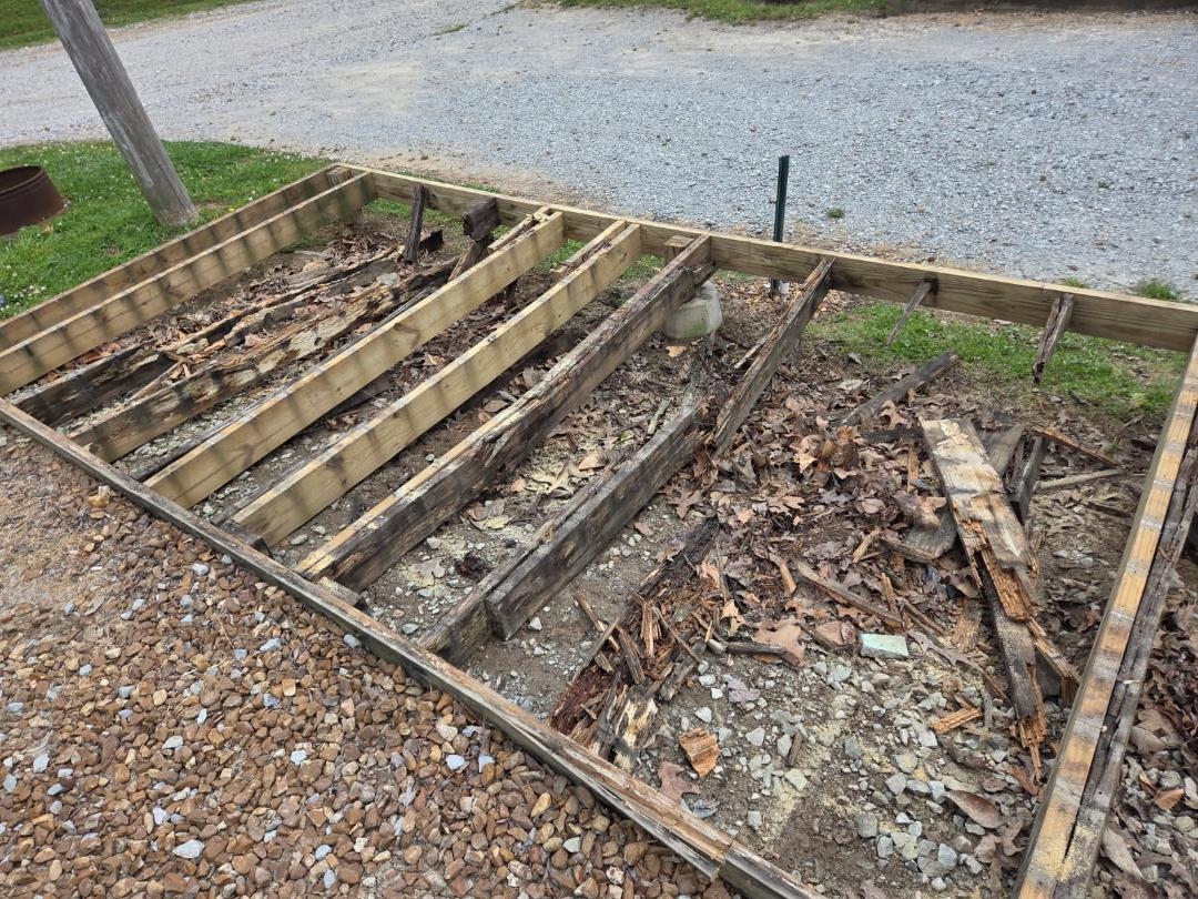

My buddy owns an RV park. He sent me a pic of one of his camper decks from the prior owner that has rotted out.
He knows it has to be off the ground or it will rot again. Just curious, what are other ideas besides another wood deck?
/ Camping Deck #2
Use deck blocks. They raise the frame off the ground by about 8-10 inches, to help keep the frame dry.
/ Camping Deck #6
At a minimum, raise the height to have ventilation on four sides, not just one. I would also add a vapor barrier under the soil to reduce rising moisture.
If he goes the concrete pad route (prefab?), I would put a water barrier and a layer of foam under it. If it were me though, I would address the ventilation and go with wood.
I think that your buddy was lucky nobody got hurt. Deck failure injuries get pretty nasty, as the knee jerk reaction is to lift your leg, and drive the the splinters in really good.

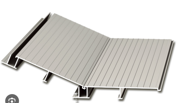

Block the treated lumber off the ground a few inches and cover with interlocking aluminum planks:
Creates a waterproof surface so no moisture seeps through onto the support structure.

There is always the issue of moisture rising from the soil.
I'm curious, do you know what is the Canadian pricing like? When I priced it here in California ten years ago it was three to four times the cost of composite decking (Trex Timberloc, etc.), and basically the cost of a 100% concrete deck. ($60/sq.ft. at the time) 🤷‍♂️
It has a reputation locally for being very hard on bare feet (hot), and icing up easily, but great for decks over occupied areas.

Not sure of the current pricing. I used the aluminum on my 14' x 22' deck back in 2006 and the price was 2.5 times Trex and 3 times that of treated wood. Pricey, yes but it still looks new today with absolutely zero maintenance. I'd be looking to replace or resurface the others by now.
I chose a light tan color and it isn't bad on the feet in summer. It does ice up easily, but it also thaws quickly making it easy to shovel off. The biggest advantage is, it keeps the area under the second story deck bone dry.
