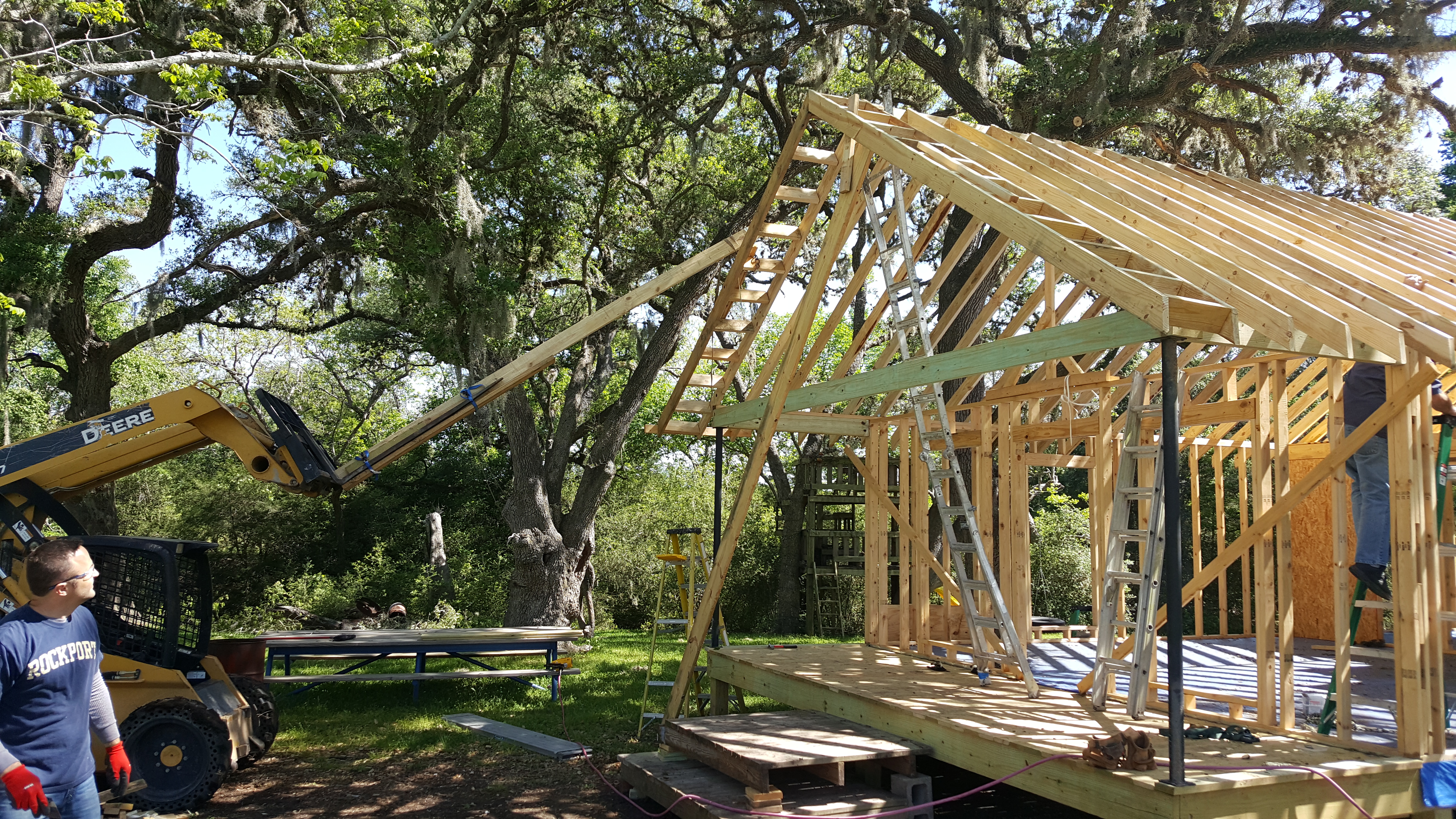

Continuing to make progress. Next up is sheathing, rigid insulatioun, and metal roof. Almost done with the big visually interesting stuff. Soon we will be working on the tedious electrical and plumbing.

Sheathing is done. Man, if only we'd made it 6:12 instead ...
   / Camp house Build #36
yeh generally I consider 6/12 the steepest that can be "walked" of course guys that do it every day will walk much steeper......whats that pitch.....looks like 8 or 9?.......Jack

It's 8:12. I can walk up it but not down. I wanted to install ZIP but my BOL didn't want the extra cost. Felt paper is going to be a major pain. I did a little research and looks like installing vertical is approved as long as the overlap is sufficient. I think that's what we are going to do.
   / Camp house Build #38
Having that equipment is a lifesaver on some of that roofing and gable end work, it looks real nice.

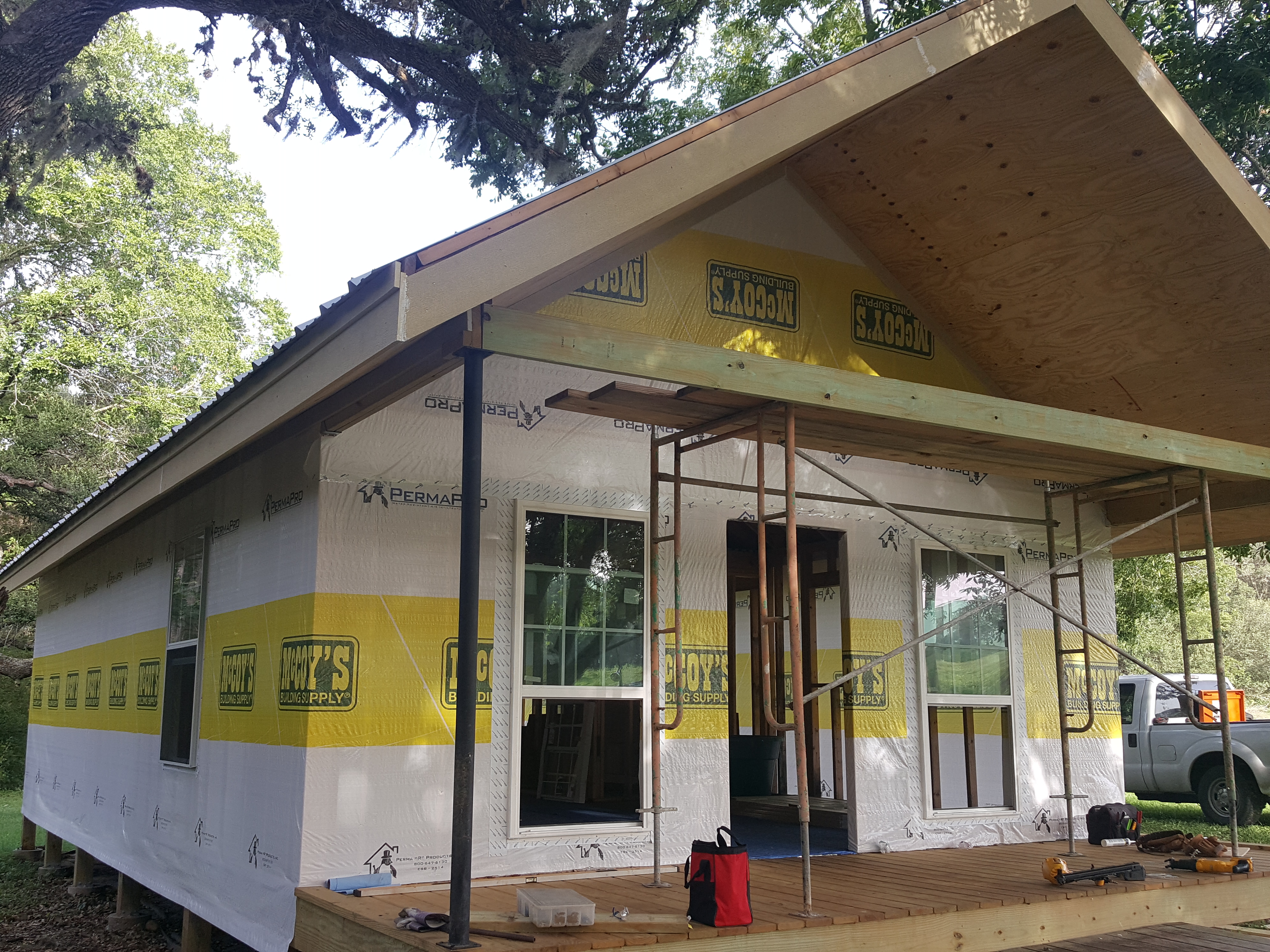

Roof finished and house wrap installed. Just finished trimming out the soffits and fascia. Next up is siding.
