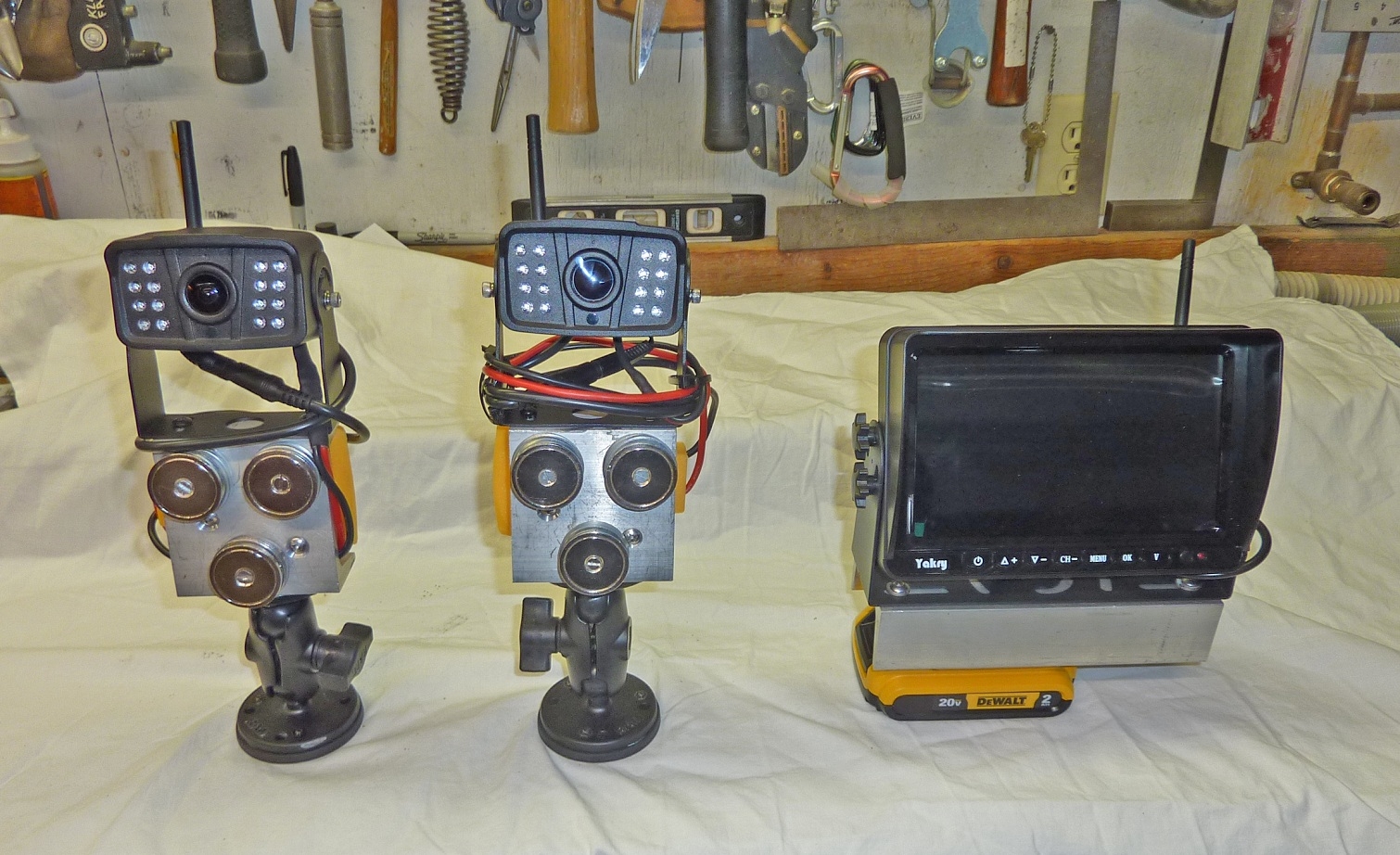

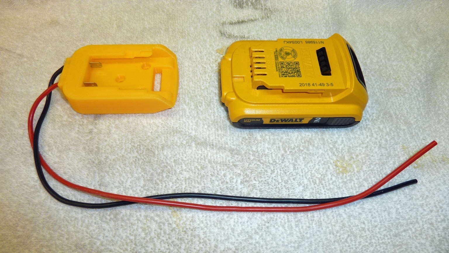

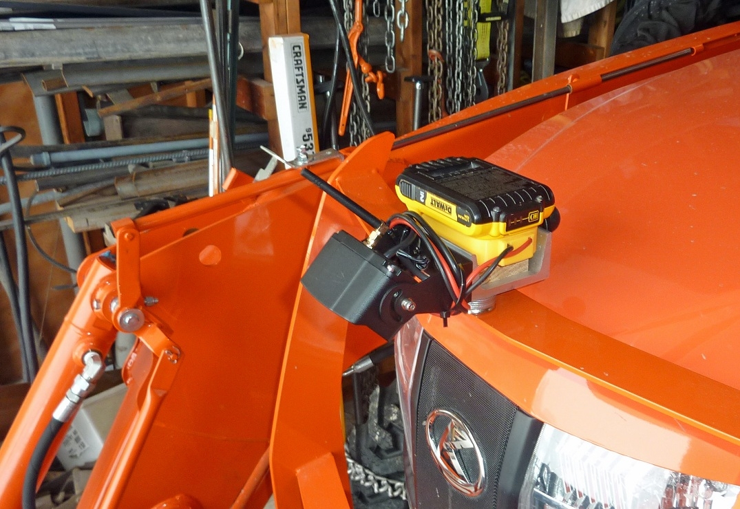

I never had much luck trying to mount a tractor camera to be able to see detail in every location. They're great for general viewing but not for up close detailed work like lining up some attachments.
The solution for me, was to use a portable battery powered wireless system. That way, I can put the cameras where they're needed on a temporary basis.
There are many such portable systems available, but they can get pricey. Most use proprietary rechargeable batteries which always seem to need recharging every time they're used.
Out of frustration, I made up my own using a fairly cheap wireless camera system. I power it with cordless tool batteries which I always keep charged for tool use. The cameras and monitor attach with strong magnets. They can be placed almost anywhere on the tractor or even on the ground near the work location. The system is also easily swapped between tractors.
Here's a link to a post on how it was done with links to the parts:

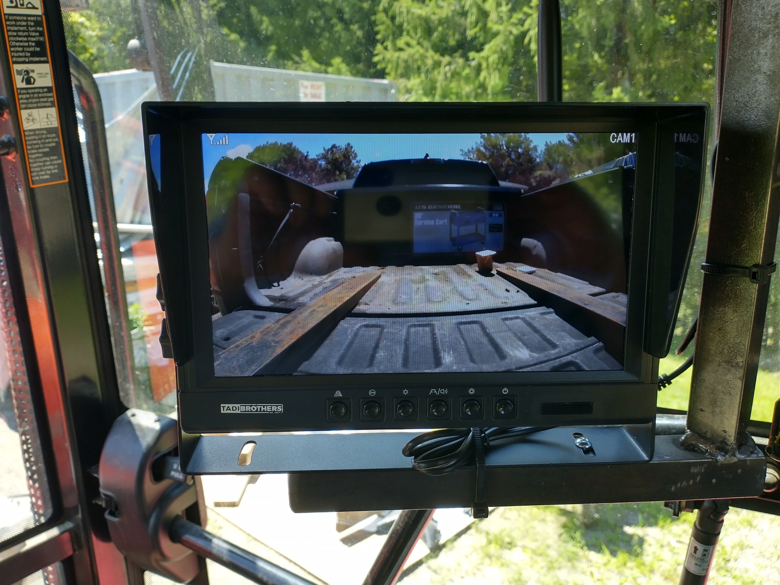

I wonder if the RX 7320 is similar to my Branson 8050 in that it is difficult to see where the ssqa mounting plate is in relation to the attachment. The hood and loader frame blocks the view to the attachment area. If I open the door and lean out to the left past the loader arms I can just barely see one side of the attachment to line up with the ssqa plate. I have a wireless camera system with the camera and battery on magnets which I can set on the front cross torque tube which definitely helps the visibility to connect attachments and also helps with the pallet forks immensely.
Mine is a Tadi brothers system which certainly isn't the least expensive way to go.
Order Your Wireless Backup Camera from Tadibrothers Today!

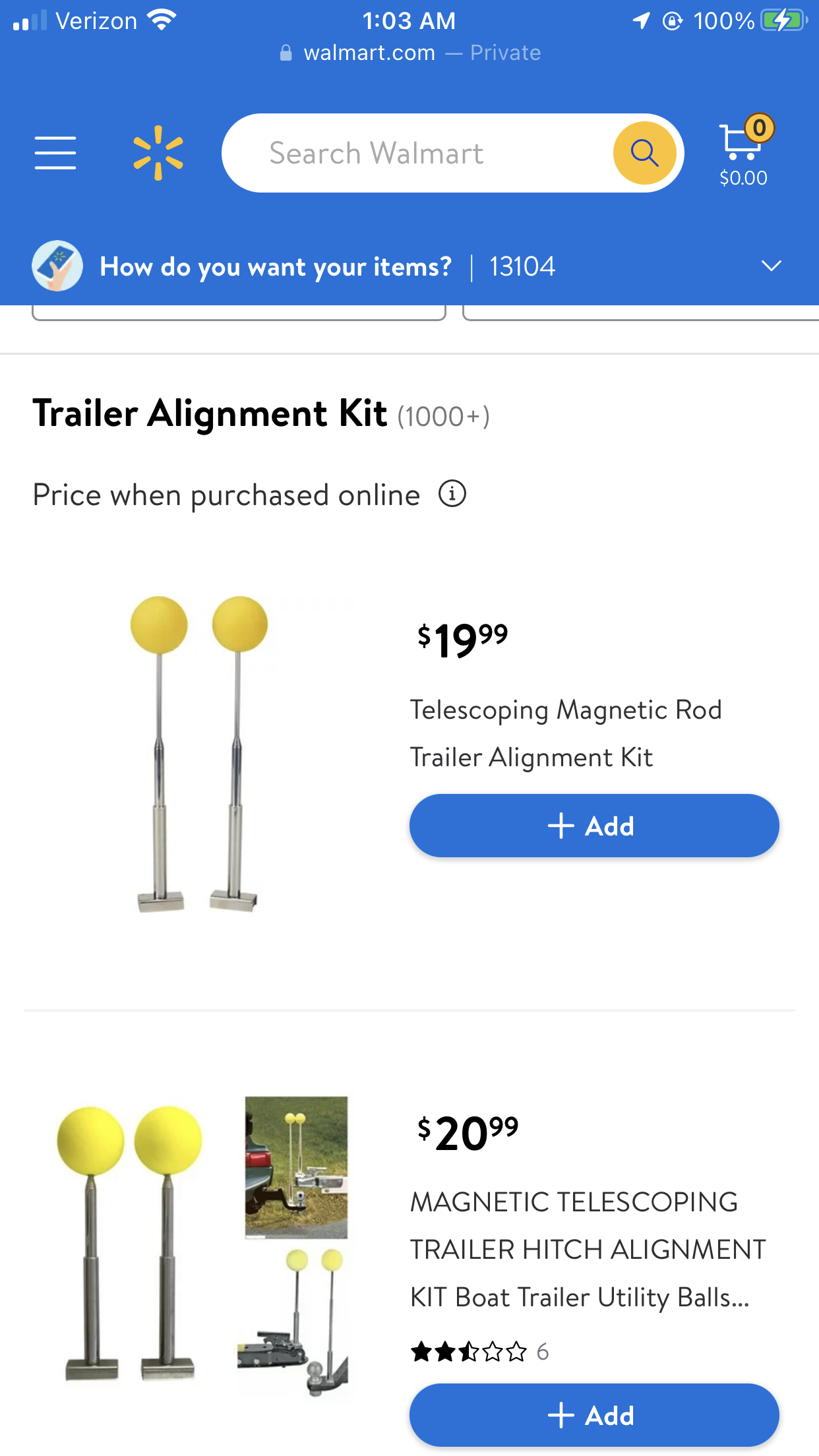

If the camera is desired for the ssqa, one thought for a simplistic system is like the old “tennis ball on a magnetic mount” used when backing up to hook up a trailer
Could duct tape four long fluorescent fiber glass snow stakes to four magnets. Put two on the implement at the outer edge of the ssqa bracket, and the other two on the ssqa plate on the loader arms in the same location. That would at least let you line it up fairly accurately.

Something like this is what I was trying to describe. Get two pairs and keep them in your cab. When it’s time to hook something up, attach one pair to the tractor ssqa, and the other pair to your implement at the same location. Should help you line it up. When it’s hooked up, pull them off and throw them back in the cab.
