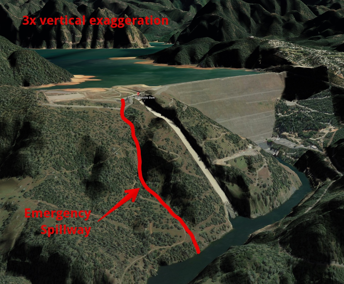

I haven't seen one post predicting the dam failing. There are many concerns that the lake could indeed drain from a failure of the emergency spillway, and cut a new channel right there.

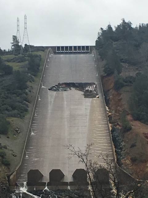

When the runoff decreases they just have to fix the spillway and it's better than new. There's nothing wrong with the dam as far as I know. The emergency spillway may never be used again.

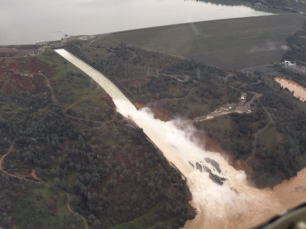

Actually, clearing the outlet pool downstream, not upstream. All that erosion filled the outlet channel and raised the level at the turbine outlet so high that they had to shut down the turbines. When they get that downstream channel cleared they can run the turbines to help lower the reservoir level, as well as generating electricity again. I think the numbers are 13k cfs through the turbines. For comparison 100k cfs was going down the spillway for a few days (now reduced to 80k), and the uncontrolled overtopping of the emergency spillway was some 12~13k cfs.

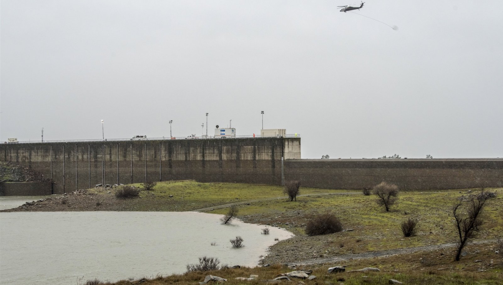

Backside of the spillway today.
/ California Drought #300
That is a good picture. Hasn't anyone at the dam come up with some original drawings that show how that wall is built and secured to the base rock? It can't just be sitting there on dirt.
Maybe in here somewhere:
