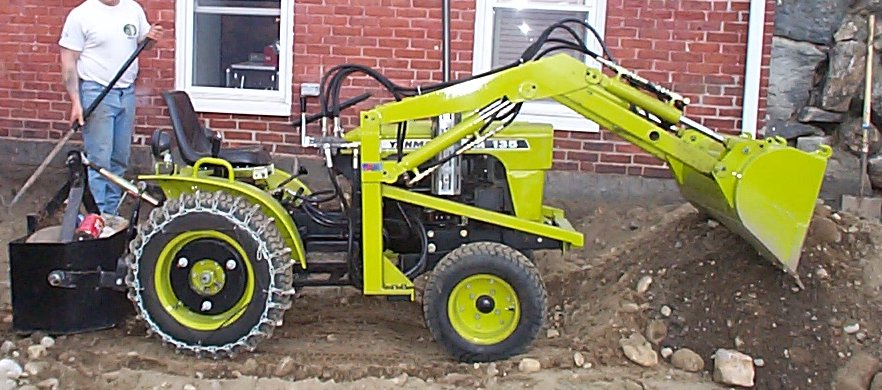

I built a CadPlans 907, total cost was about $1,000. However, It is a smaller loader. The plans were excellent, the loader came out great! I was also a very rewarding experience! I would do it again in a heartbeat, in fact I am considering building a backhoe.

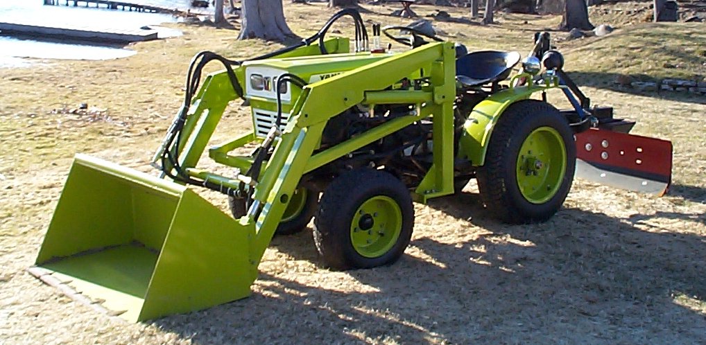

Attached is a second picture of my loader, with a new samller bucket with a toothbar.

Matt , great job on the loader, looks very much like one that came from the factory, except for the color.... Yuk... I'm hoping that's just the primer base paint and the finishing color will look more "traditional". /w3tcompact/icons/wink.gif
gary
/ Cadplans loader #6
That IS the finishing color!
Eugene
/ Cadplans loader #7
That Cadplans 907 loader looks very good. I have been seriously considering building one for my Satoh Beaver tractor. I'd be interested to know the breakdown of the price.... Is that basically the cost of parts, and did you do the cutting/welding/assembly yourself?

Hi Everyone, Thanks for the comments on my loader. That is the correct factory color for that vintage yanmar tractor.
As for the price breakdown, I don't have the listing in front of me, however, here it is from memory (approximate):
Hydraulics, from CadPlans/Metkit..........$700.00
Steel and additional hydraulic fittings....$250.00
Paint, Dupont Centari.........................$100.00
I had some custom fittings made in the machine shop where I work at N/C.
Most of the steel was aquired from the scrap bin where my brother works.
There are obviously additional costs in welding, grinding, and shop supplies etc. that were not tracked.
It took two of us approximatly 2 months, nights and some weekends to build.
Yes, a 20 HP would run it, my tractor is a 13 HP diesel, with about 1000 lb machine weight not including loader and added weight.
Hope this answers everyones questions, if not feel free to post more, or email direct (mbrule@rcn.com), I also have many pictures of all phases of contruction.
Matt
