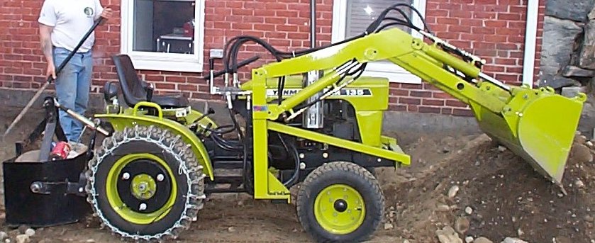

Hi,
I built a cadloader for my Yanmar (model 907 I think). I love it, building it was a blast and it is surprisingly useful, on such a small machine.
The plans were excellent! I got the hydraulics from MetKit, and obtained steel locally.
A photo is attached.
Matt
