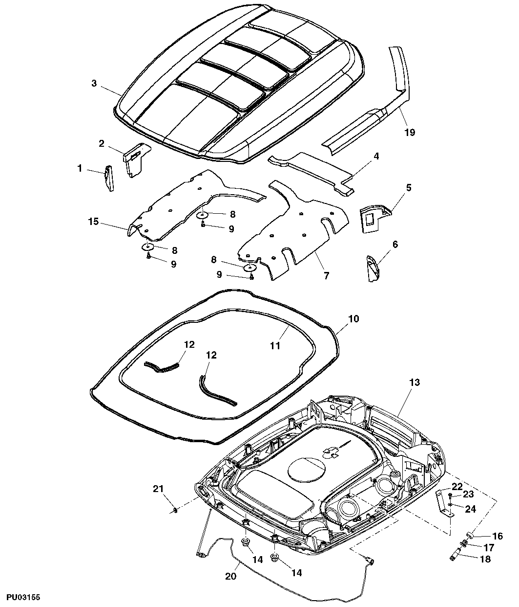

anybody know how to remove roof on jd 4720 cab to clean evaporator?
   / cab roof removal #2
I'll guess the thirteen nuts(parts key 14) must be removed to raise roof. I know a lot of long screws around perimeter of my Kubota have to be removed to raise it's roof.
