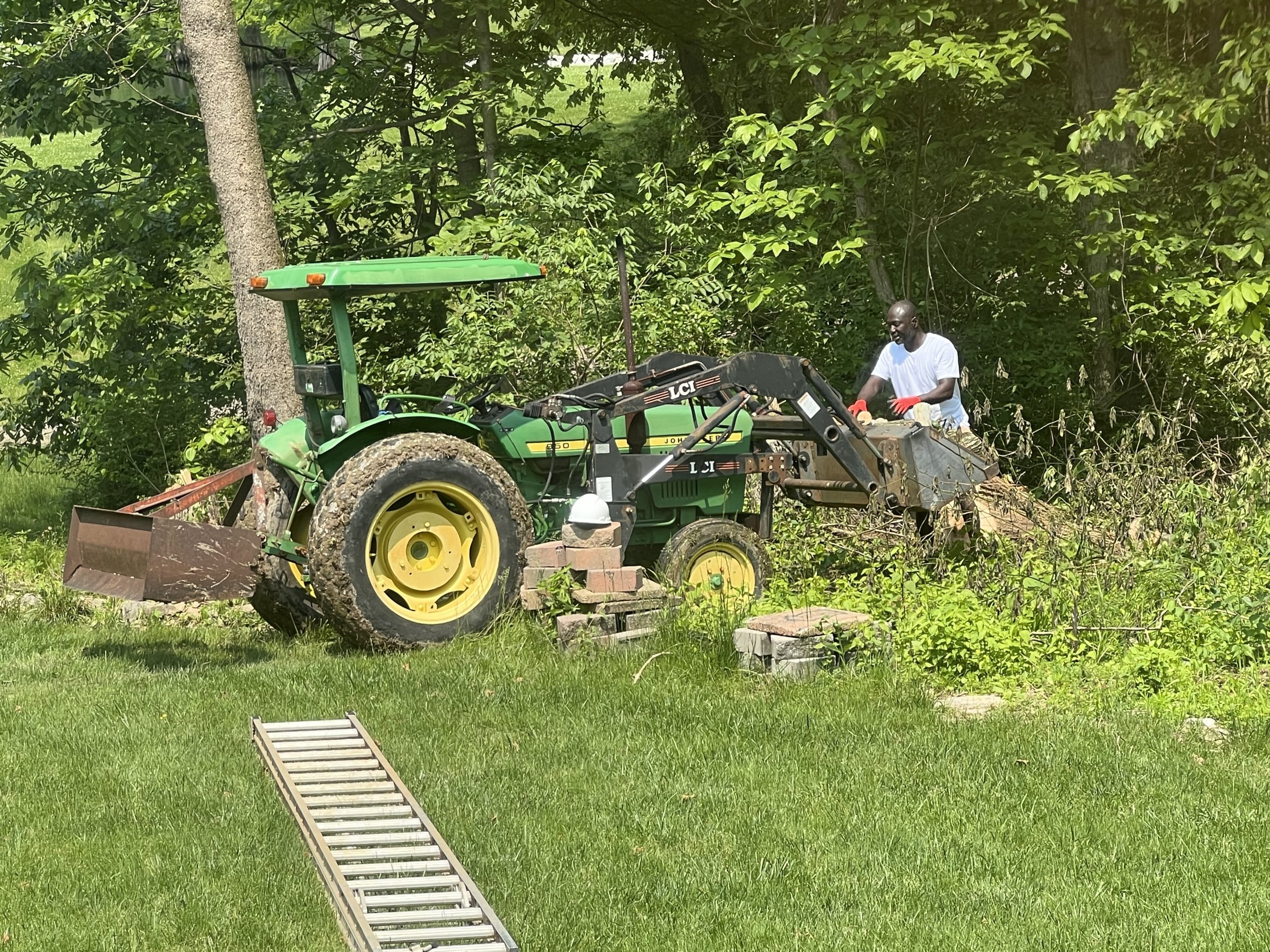

A 24 HP “tractor” is a lawn implement. Not a tractor. Get something that will move a bucket rapidly (hydraulic pump with a set a balls) and lift a ton in one gulp. 38-50 HP at least! Get a John Deere, the rest are crap and everyone here will defend their ****show $1500 Walmart grass cutter.
I bought a ‘79 JD 950 (yes it’s a garden tractor) for $4K and put another $4.5K into it. Love it in St Louis.
