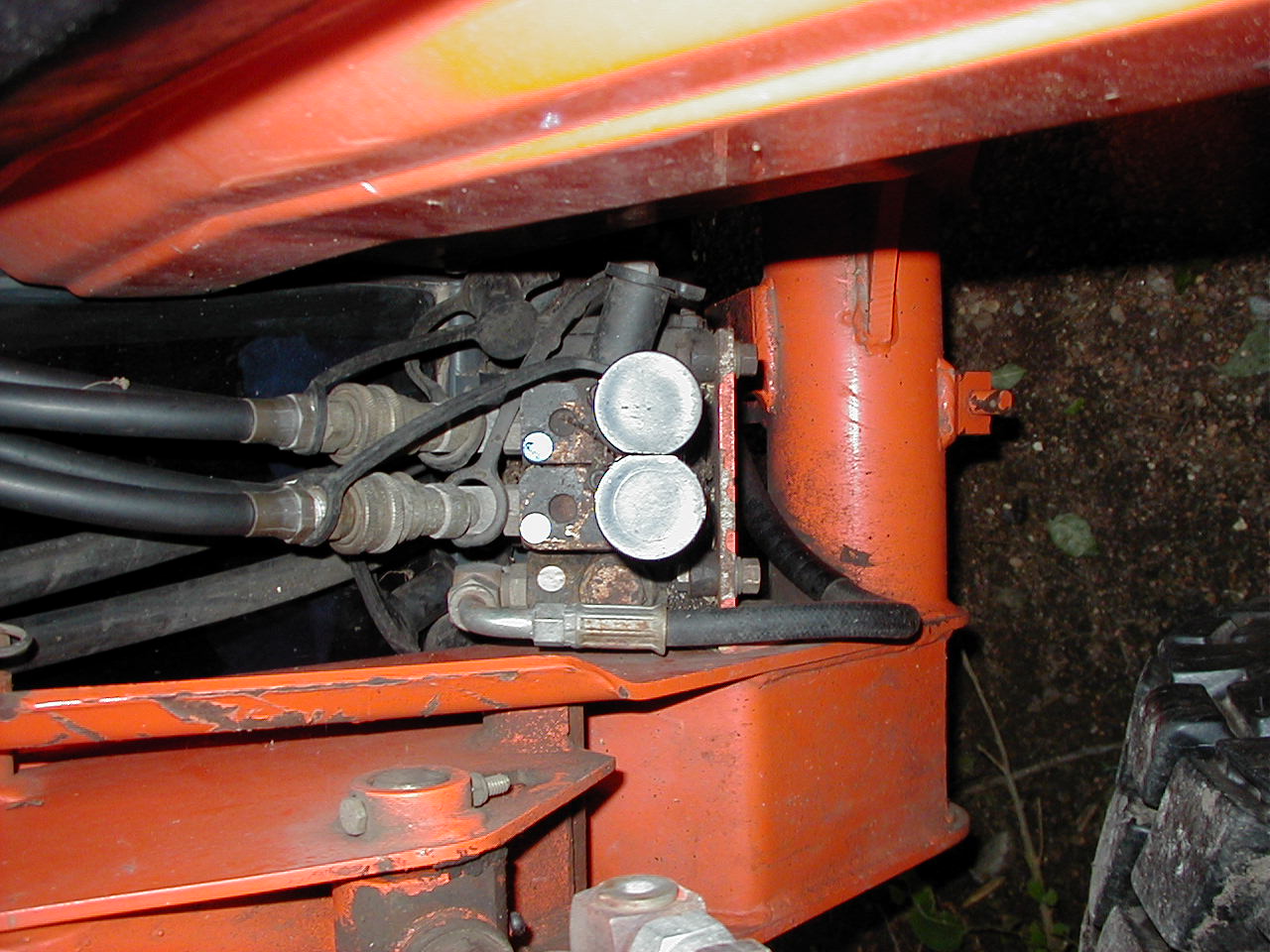

The Laurin cab on one of my L5450's was installed with the FEL control valve bolted to the loader frame, extending through a cab window. To make loader removal easier, I've decided to bolt the valve to the cab instead and put quick connectors on the loader hoses. Another plus of keeping the FEL valve mounted is using it for my front snowblower.
Seems like it might be good to arrange the connectors so each circuit can be plugged into itself when the loader is off. That would avoid ever having a hydraulically locked connector. Any thoughts?

I should have been clearer and asked for cab owners to post pictures of their loader disconnects.
I have mounted the valve so it stays with the tractor - that way I can use it either for the loader or front-mount snowblower. It tucks in nicely in the cab next to the dash so I don't need a remote cable setup. The hoses go out to the disconnects located in between the loader and the hood.
My question is whether to have all the female quick connectors on the tractor side, or the implement side, or alternate them so the lines of each circuit can be connected together for free flow when the implement is not on the tractor. Connecting the lines together prevents them from being pressurized when the valve control gets bumped with no implement plugged in. This issue is the same regardless of where the valve is mounted.

You are right about coupling the lines together, it may make a high pressure lock problem disappear. On my and all other cab tractors I have seen the tractor has the female fitting and all attachments have male. There may be a reason for this, or it may be just how it has always been. I have to think it seems that it could be easier to attach with male hose ends and fixed female ends. But there is not a lot of space around those fittings anyway. KennyV.
/ Cab-mounted FEL control valve #6
I've always installed quick connects like you are saying (alternate male and female) for two reasons: coupling the implement lines when not in use keeps dirt out of them (without having to use caps), and (not being the sharpest knife in the drawer) I can't get them mixed up when re-connecting. Now that I think of it, I've never had a pressure lock problem, so maybe I now have a third reason.:D
