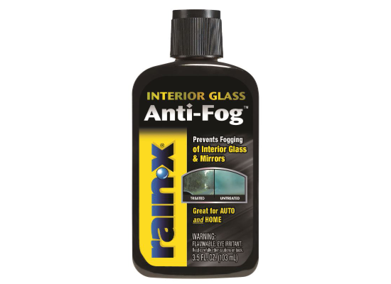

Ya yours is a science problem lol, too much glass (too much surface area for a tractor heater to warm all the glass), without AC you can't remove the moisture from your cab so the air gets hot but the cab is filled with moist air (like a car in winter running the air on recirc) like most of us with cabs your getting "cold spots on the glass" which cause the inside moist air to cool to it's "dew point" and condense. opening the window allows for dryer air in and moist air out, some install extra heaters /fans that warms the glass more reducing cold spots. Using the RainX helps a bit
