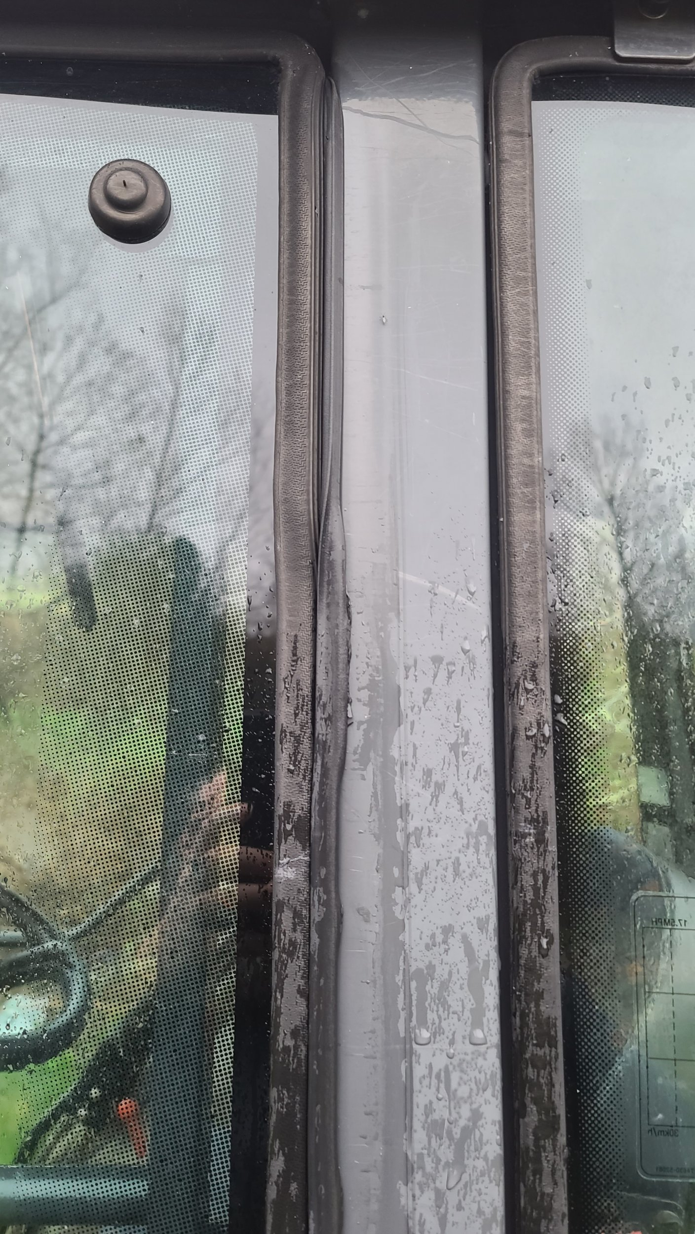

I have a dk45s cab that the door caught on a limb and pulled out the door piston and has damaged the door seal. Does anyone know if that's repairable or a door replacement?

Kendrick, it's kind of hard to tell where the seal is and how it's installed by your pics since I'm not familiar with your tractor. I did try to locate the seal on a parts breakdown but no luck. It appears that the seal has just been dislocated and could be reseated. If the seal is between the glass and frame it's possible that you could take the door to a auto body shop and have them put the seal back in or replace it with a universal one.
I was just looking at the seal on a door for a 2009 BobCat CT450 which is really a DK50SE C. I think it might be the same cab but double check your year. The part is actually just called a rubber and is shown only as a small section, but Kioti P/N T4145-82521 if I'm correct. I can check with my parts place down the road because she might have mentioned yesterday that there was a new part number on that one, but they should still match up. That looks fixable on yours, but, here in Canada, that seal is about $55 CDN so maybe $40 USD. It is back ordered here at some places but available through others.
