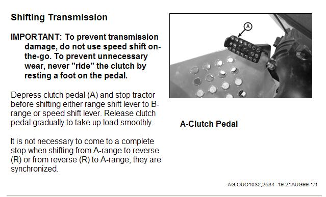

I have two questions about my 2003/2004 John Deere 5205 tractor.
First question regards the clutch. When I am shifting up using the clutch it is smooth and no grinding, however, when I want to shift down say from B-3 to B-2 or anything in between B-1 - B-4 I have to come to a complete stop and wait for a few seconds before the grinding stops and I can shift. Could it be a bad clutch, or are J.D's just like this?

Not a bad clutch. It is spelled out in the specs for the 5205, and the following is from the operators manual.
Well that's a bummer. How about a cab? Are they possible?
