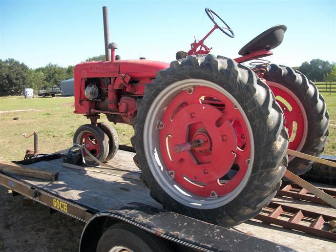

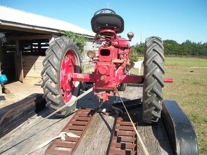

as I found her. no bat.. / bad starter. hung a lawnmower bat on her and hand cranked her to load.

I sure would like to have those rear tires..!!
Sheet metal looks pretty decent. What's the funky thing above the PTO, where the belt pulley attaches..??
Now, if it only had Fast-Hitch... Guess we can't have everything...
Sweet little tractors..!! I have 2, and are just sooo handy for so many jobs.

I always loved the Farmal wheels. It was like mags before there time.
Are you planning to paint it Blue?!:laughing:

judging by the torch marks on the plate, I'd say it was blanked off by the prev owner.

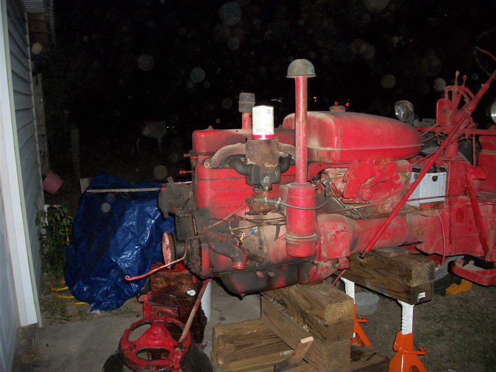

a lil progress today!

If I'm not mistaken, you have a "distillate" manifold on your C...does the tractor have an "extra" small fuel tank? BobG in VA
