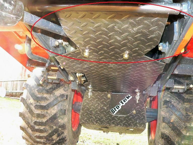

I've only had experience with the Bro-tek product. Just posting to let you know that there are actually 3 plates available. I use all three - after learning the hard way.
[edit] Found a pic I took. Not promoting Bro-tek over BXpanded but I've been happy with these.
Z.

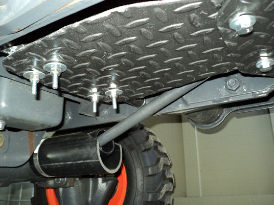

   / BXpanded vs Bro-Tek Skid Plates #4
I imagine that the BXp plate is _much_ easier to remove. I consider the Bro-tek plates to be "permanent". Here's a different look at the front plate. Also in the pic is a guard I made for the front u-joint and pinion shaft seal. The stock guard has a big slot in the bottom that exposes the u-joint.
My story is a little different than most. I didn't lose the HST fan. Tall grass wrapped the drive shaft and ripped out the exposed wiring. Also ruined the rad fan. Got that fixed and the next time out grass wrapped the front pinion shaft and took out the seal. Glad I'm the only one who's done that...

   / BXpanded vs Bro-Tek Skid Plates #13
A side notes.. The transaxle case is aluminum, bro-tek skid plate is the only one that covers this area.. Goes all the way to the back.
A rock has damage.. Complete rebuild was needed...
