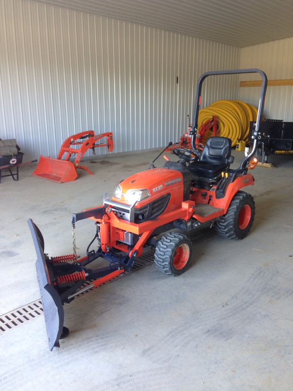

i have been looking at these for my bx25. Maybe i will just look for a plow from a jeep or small truck and fabricate my own mount. Was hoping to just buy one already done but... Btw i love my bx25:))
This is an old jeep plow and a frame that hooks up in same location as my loader. Works very very well!
Thats a great looking setup:) nice fabrication btw very professional looking. I think this is what im looking for, looks stout too

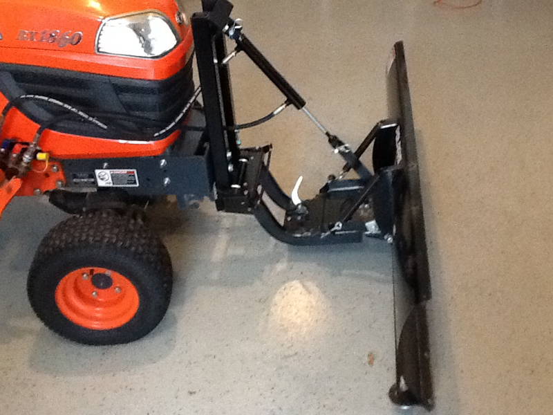

I made a Polaris Glacier II mount for my BX 1860. Had the plow left over from my ATV, made up a mount for the Kubota and added a hydraulic cylinder to raise and lower it. Actually works a lot better on the Kubota than it did on the ATV due to power steering and the hydraulic lift in lieu of a winch. Figure I have about $600 into it including the Glacier Plow. The hydraulic cylinder was the biggest additional cost at $80.

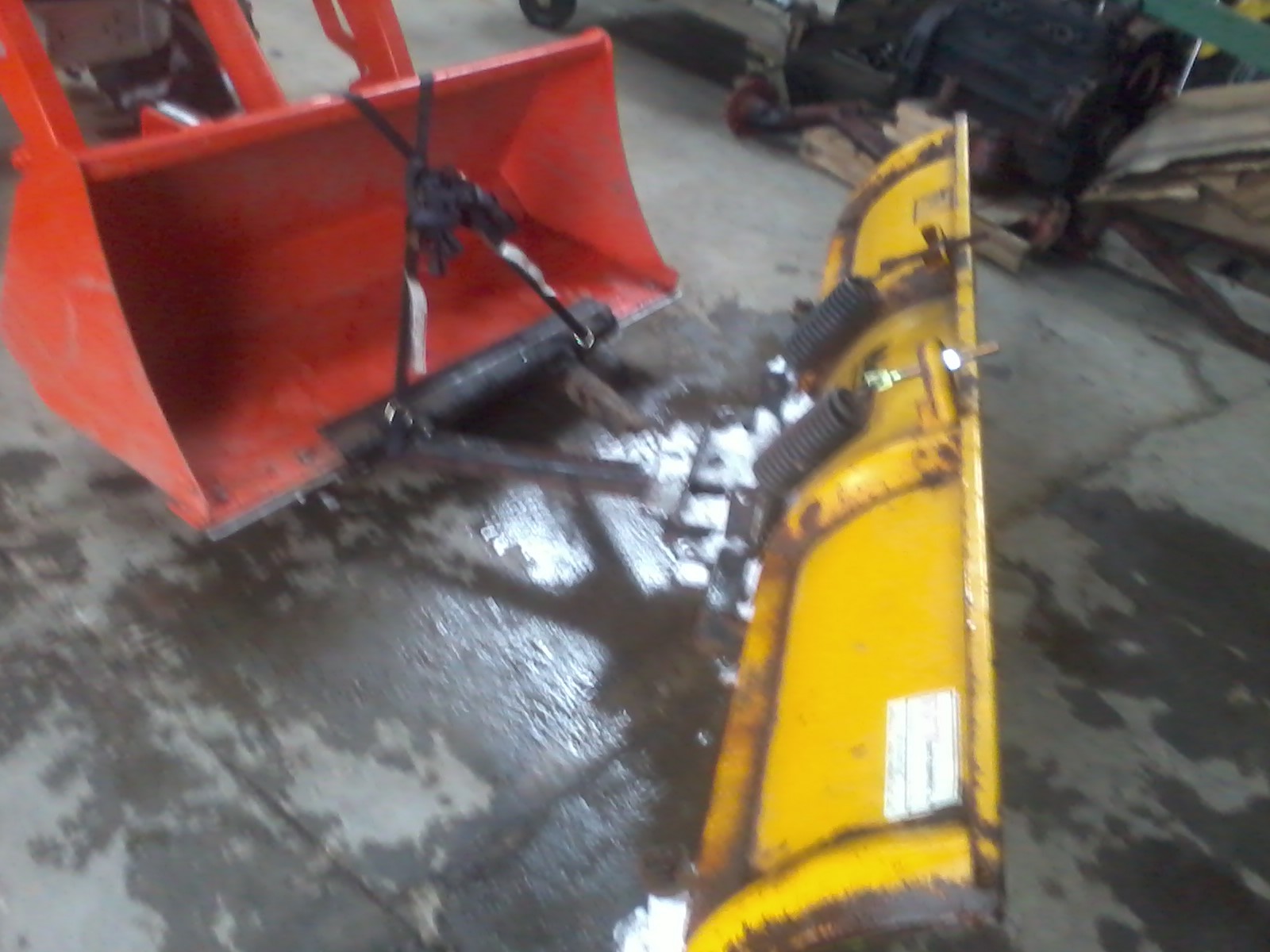

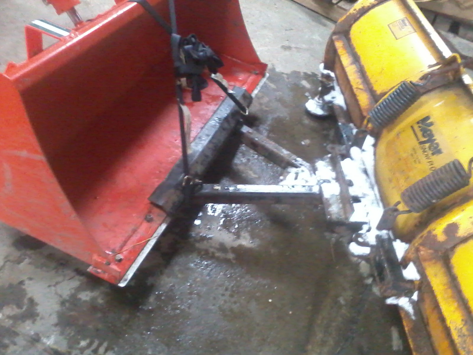

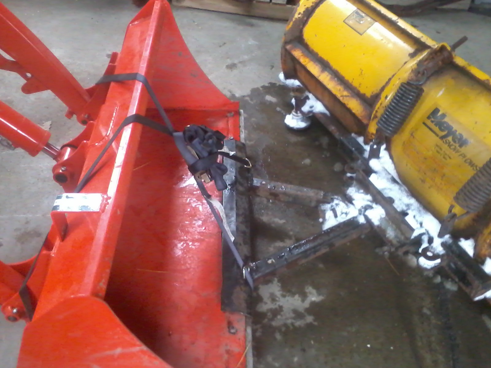

I made mind out of a 6 1/2 ft meyer blade I found for a 100 bucksV__5B2B.jpgV__7103.jpgV__4987.jpg
   / BXpanded snow plow? #99
I made mind out of a 6 1/2 ft meyer blade I found for a 100 bucks<img src="http://www.tractorbynet.com/forums/attachment.php?attachmentid=350783"/><img src="http://www.tractorbynet.com/forums/attachment.php?attachmentid=350784"/><img src="http://www.tractorbynet.com/forums/attachment.php?attachmentid=350785"/>
Would you show some close up pics of the base mount to the bucket lip? And I don't see any mechanism for lifting the plow when curling/lifting the bucket. Could you explain your design and how effective it is? TIA
   / BXpanded snow plow? #100
I will try n get pics for you later not home right now but I used a frame rail I had off my old 2002 ford truck that I had to take off to mount a plow just cut the side off to make a u channel welded it to the frame were the loops were for the cyl lines were the rachet straps on hooked on to the spot were the cyls used to be n I crossed them so it don't slide works great I have a 180 ft driveway with a 3 car turnaround the only thing is if we have more than 8 inchs I take my time I will get more pics thanks for looking
