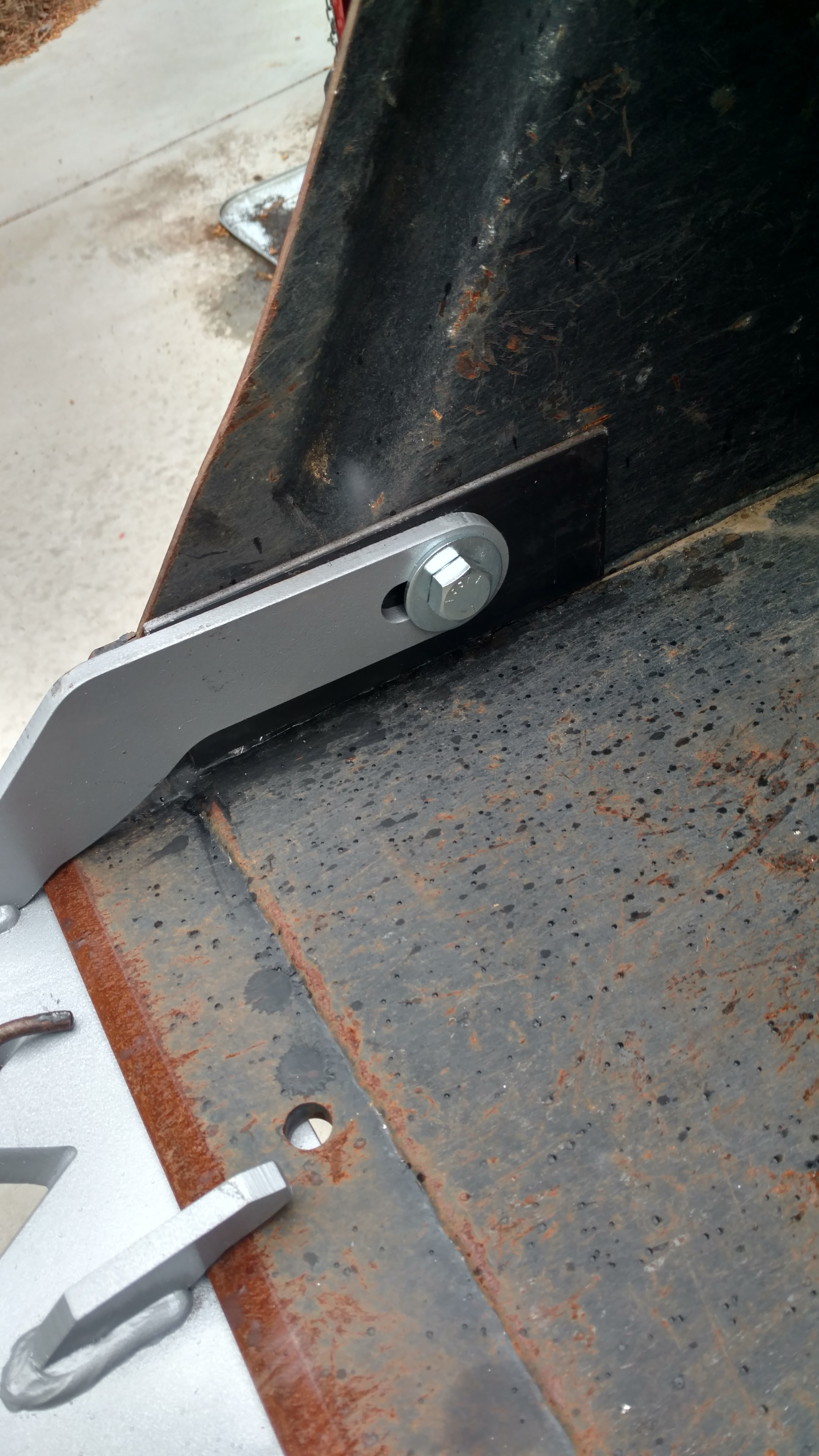

   / BXpanded Piranha Tooth Bar~ Best method to use it.... #30
Added a couple pieces of 1/4" plate, secured by the new longer mounting bolts. Now it all lines up properly, and looks right to me. Mounting arms are well supported, with just a little extra work. I just couldn't live with it as supplied.View attachment 604309
I would say you have a mild case of ocd. This is absolutely NOT how the bar was designed to operate or install and you specifically thumbed your nose at their engineering. Those tabs would have bent out to fit your bucket perfectly. You put a lot of extra effort in for really nothing. Those tabs aren't "stronger " than your bucket like you stated, because they are unsupported. They WOULD have bent out to perfectly fit your bucket.
Even if Bxpanded was in err though, don't try leaving a less than 5 star review, they pretty much cull all the lesser reviews from their website. I know this as a matter of fact.
