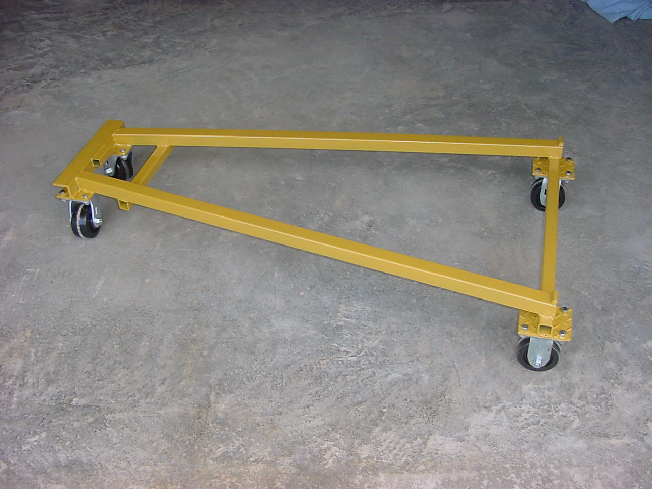

Here is one I built from free tubing!
Looks very familiar....
I did buy NICE phenolic casters. I think 800 lb since you put a lot of weight on the small end when removing.

Deano, Nice work, I hope I can do the same. Can you tell me the height of the dolly? My backhoe is off the tractor and stored for the winter otherwise I would instal and measure height. Thanks,

Oh my, that does look familiar, almost the same as the grey one I have. ;)
It reminds me - to the original poster - you probably want to make the one end solid casters and the other end swiveling... prevents it from rolling off if not on a perfectly level surface.

Correct on swiveling casters!:thumbsup:
