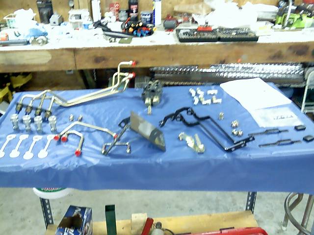

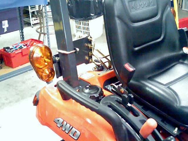

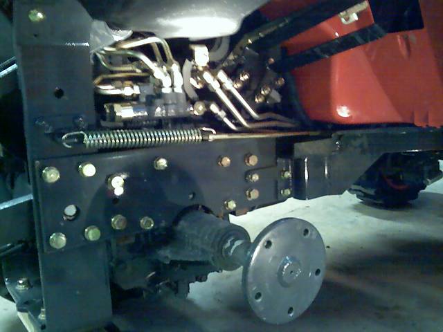

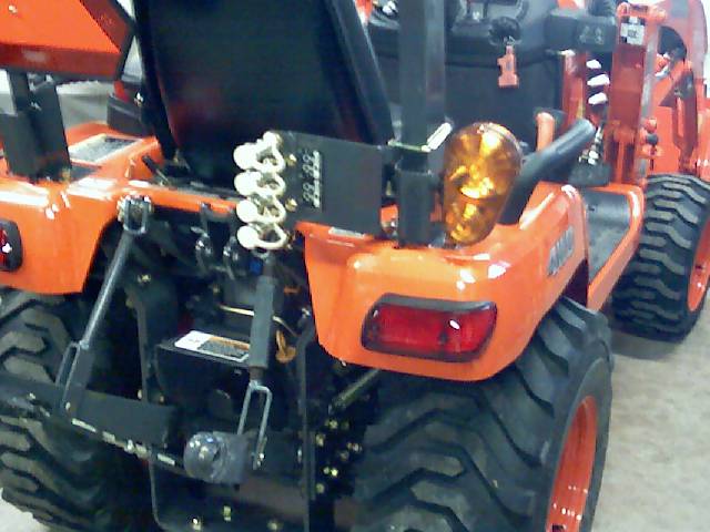

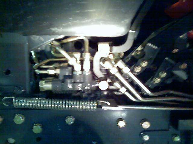

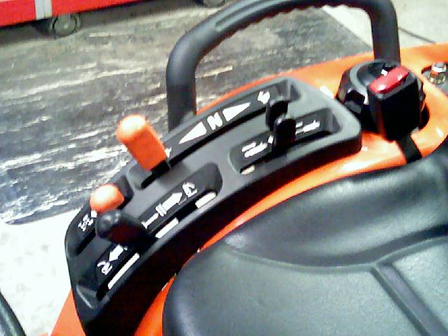

This weekend I installed the BX7326 Rear Aux. Kit on my 2350. This kit is very well made and very well designed. It was relatively an easy install probably taking 40 minutes at most. I only had two minor problems with the install. The first one is the bolt supplied with the kit to hold the valve onto the side of the transmission is wrong. The bolt supplied with the kit is a 12mm it should be an 8mm bolt. The 12mm bolt won't go through the valve and the boss on then side of the transmission is 8mm, no big deal. The second one is indexing and tightening the fittings on the valve before installing (per-instructions). You will need to leave the fittings slightly loose to line up with the steel lines. After all the lines are started, tighten down the fittings. This takes an assortment wrenches and crows feet line wrenches. Again no big deal.
This kit is very well designed the all the lines run nice and tight to the sides of the transmission. Operation of the levers is convenient and smooth. The QDs are in a good location to.
All I need now is to order a set of male QDs and top link cylinder.
Here are some pictures of the install.

Wow! Thanks for the pictures, and words about the remote install. That is one slick looking installation. I wonder if there is a kit for my B2620 like that? I would think that you have more than doubled the usefullness of your set up with that addition. Keep us possted on how it works out, and thanks again for the great pics of the install.

Judging by where the levers go that would be where my existing cruise control lever is located
I guess this kit would only fit the BXxx50 series then
Correct?
