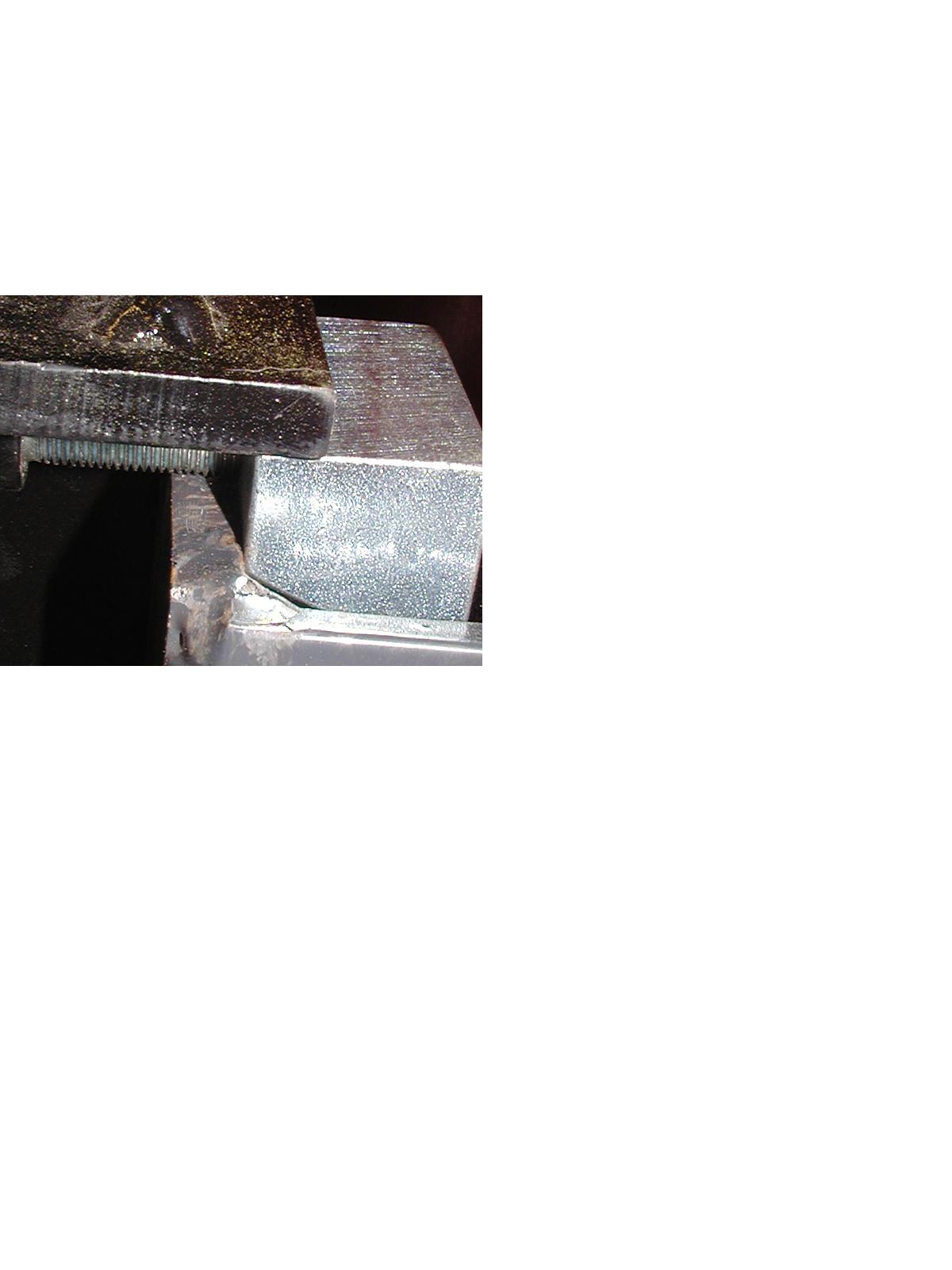

I trailered the BX23 to the dealer to have the quickhitch and snow blower installed. After getting the tractor home, I noticed that the lefthand wedge did not fit above the tractor's frame, as it does on the righthand side. I also noticed lockwashers installed on the T-handled bolt that pulls the wedges. With the lockwasher, only a few threads were caught in the wedge. The dealer did not give me the quick hitch installation manual, so I don't know if the lockwashers are supposed to be there, but because the T-handled bolts have nylocks, I doubt that the washers are supposed to be installed.
Without cutting or grinding, there is no way to make the left wedge come above the frame like on the right side. Since the dealer is a couple of hours one way, I would prefer to fix this myself. Has anyone else seen this problem? If so, how did you fix it?
I will attach a photo of the bad fit.
Thanks

Can you post a picture that shows more of the assembly? /forums/images/graemlins/confused.gif
If you do a search for Quick Hitch you find there are a lot of comments about having to fit the Hitch to the Tractor and Attachments. /forums/images/graemlins/tongue.gif

Some fitup is not unusual but the dealer should have done that. He also should have given you a manual for the quickhitch and one for the blower. I don't recall if mine has lockwashers but I do recall the manual saying to tighten the Tbolts every hour as they can loosen up. They may be the dealers fix to keep them tight. You could try loosening both and pulling up to shift the left wedge up and then tighten both (it may be tipped).

Thanks for the ideas. I agree that the dealer should have seen the problem and corrected the fit. There were LOTS of other errors on the blower installation, so I'm not surprised. The dealer is now sending a manual for the quickhitch. I did get a manual for the blower.
I checked that the QH was not tipped, and it was up as high on both sides as possible. The dealer said grind the frame, so I did. the wedge now comes partway forward on the front of the frame, and the load is down, as designed.
The following link has three photos and two sketches of the problem and the fix. http://www.cosner.com/kubota

Thanks for the answer. I cannot tell for certain, but it looks to me like the right side wedge on your tractor has the problem I was asking about. The sloping part of the wedge should rest on top of the tractor frame. It looks like yours is behind the frame, like mine was, and that the downward force is taken by the bolt where it passes over the frame.
Hope it's not so.
