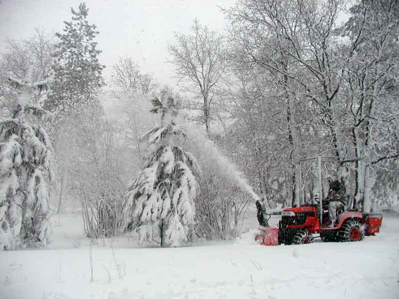

It snowed yesterday so BX2750 on the BX23 got its first use. This snow was heavy and wet. The BX2750 throws almost as far as the Honda HS1132. It moves about twice as much snow per time spent. It also has plenty of down force so it does not try to ride up over drifts. It clears the roadside berm, left by the County Plow with no problem. The skids don’t really work, in “float” to keep it out of the gravel on the driveway. Has anyone here made up a quick adjust set of big caster wheels or some other fix to handle gravel driveways. The skids work fine on pavement. The Kubota rotator and deflector work fine, but the rotator is very slow, so it’s more efficient to back up quite a way and take a second cut, rather than turning around and changing the chute rotation. I sheared a couple of auger pins on what seemed to be just excess load (no rocks). Is that normal? Also, is it normal to have to drive the piece of the pin left in the shaft?
Action picture attached.
