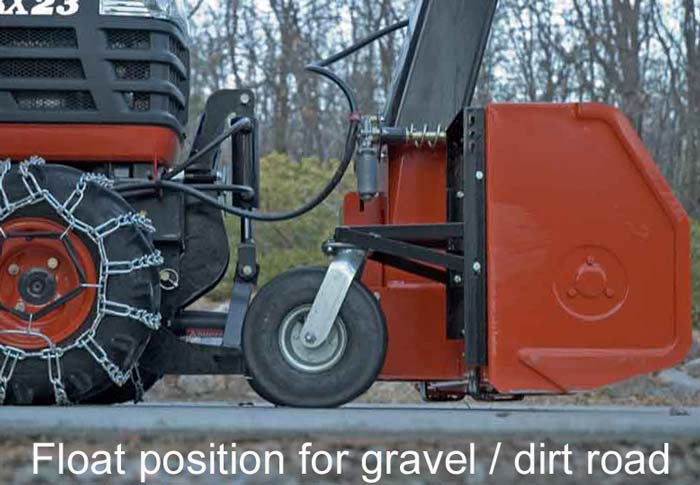

/ BX2750 Front Snowblower #5
/ BX2750 Front Snowblower #6
Just purchased this unit on e-bay. Thanks bitseeker for posting this. Never thought about this idea,but seems worth a try for us.
