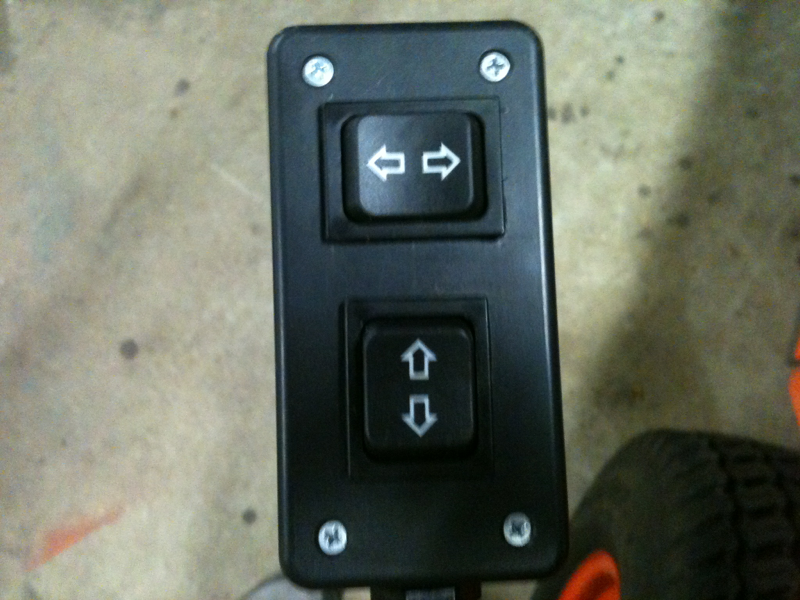

Kubota BX2750 chute rotator and powered deflector

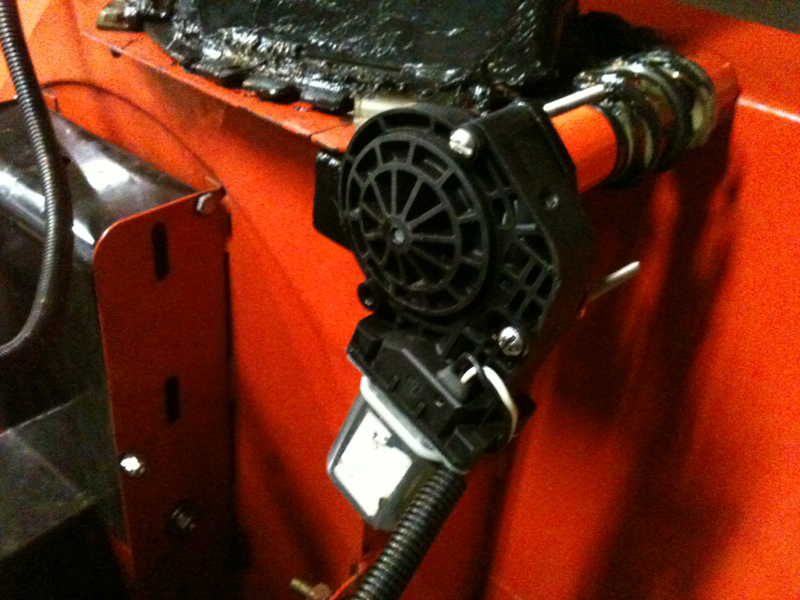

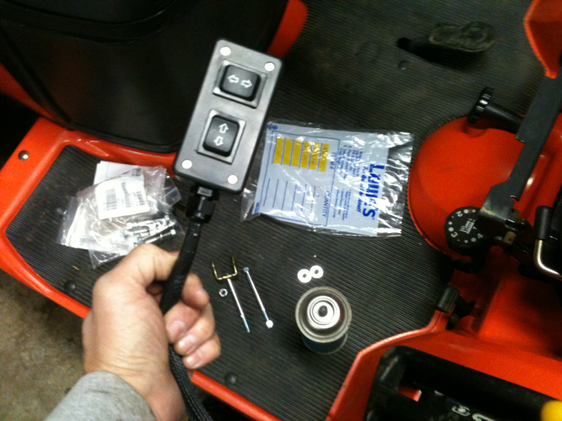

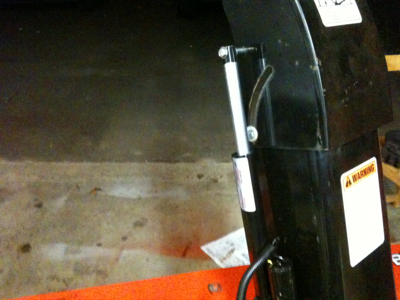

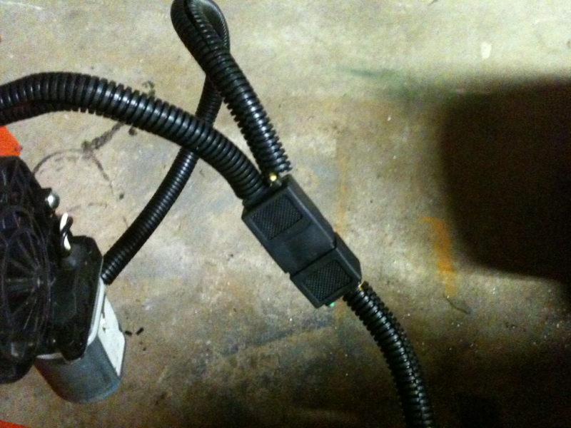

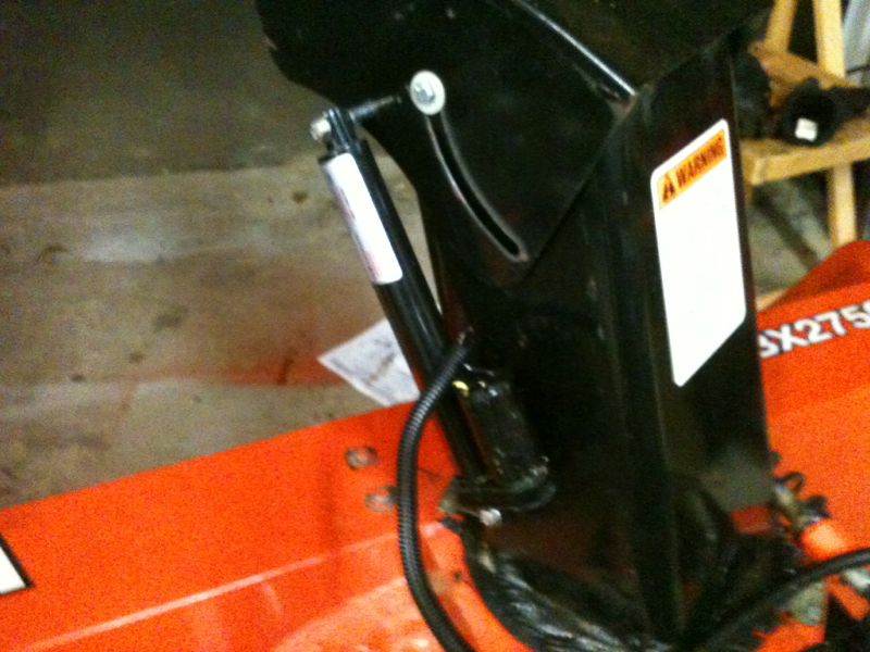

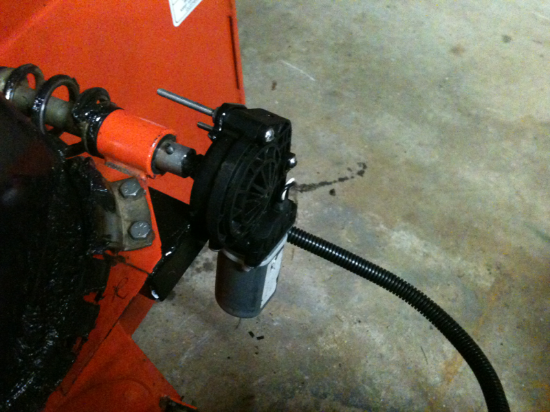

Well today I finished my electric chute control. I built a custom bracket and mourned a power window motor for left to right control. I then installed a linuar aviator for up and down movement. Now to control the motors I built a handheld control that quick connects under the seat so I can remove the remote when the blower comes off. Now just have to cut the extra length of bolts an tie up the wires

Nice design and job, Wondering if you have any details and pictures of the mount you constructed?
wayne
/ Bx2750 chute control
Thanks for the great feedback on my project I will post the images of the bracket that I custom made for the window motor. I built it out of some flat steel purchased at my local Lowes
/ Bx2750 chute control #6

Re: Kubota BX2750 chute rotator and powered deflector
... to control the motors I built a handheld control that quick connects under the seat ...
Congratulations on a beautiful installation; it looks more professional than some of the installs I've seen coming from a few dealers. Can you tell me the name and part number of the dual switching unit to control the motors please, and where you were able to buy it?
#11
I built the switching from two double pole double throw switches
