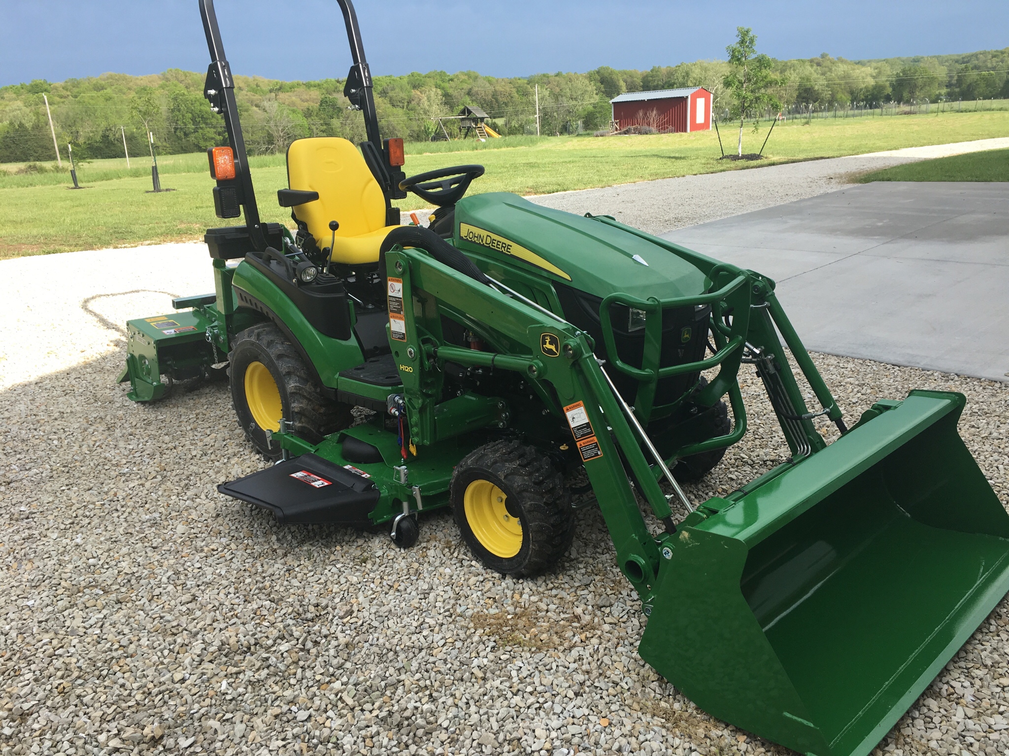

Well, it was a tough choice, but I'm going with the 1025R.
I spent the morning looking at both and there's still things I like on each of them better than the other, but ultimately I think the 1025R is the right choice and I went ahead with the purchase.
On the Kubota, I liked the Skid Steer style quick attach on the loader and the steel hood/fenders. On the Deere, I preferred the dual pedals over the treddle. The operator station, ride, controls, handling, dealers, etc where pretty much a wash. When it came down to it the deciding factor was the ease of the loader and mower attach/detach on the Deere. Kubota's isn't bad, per se, and is certainly functional. It's just not as simple and refined as what's on the Deere.
Unfortunately Deere is out of 1025's right now, but the next one coming from the factory I have dibs on. So hopefully should be here in the next couple of weeks. I also got the Frontier 48" tiller and the iMatch hitch.
Thanks again everyone for their advice and wisdom.

Arrived today! Can't wait to play/work with it this weekend.
