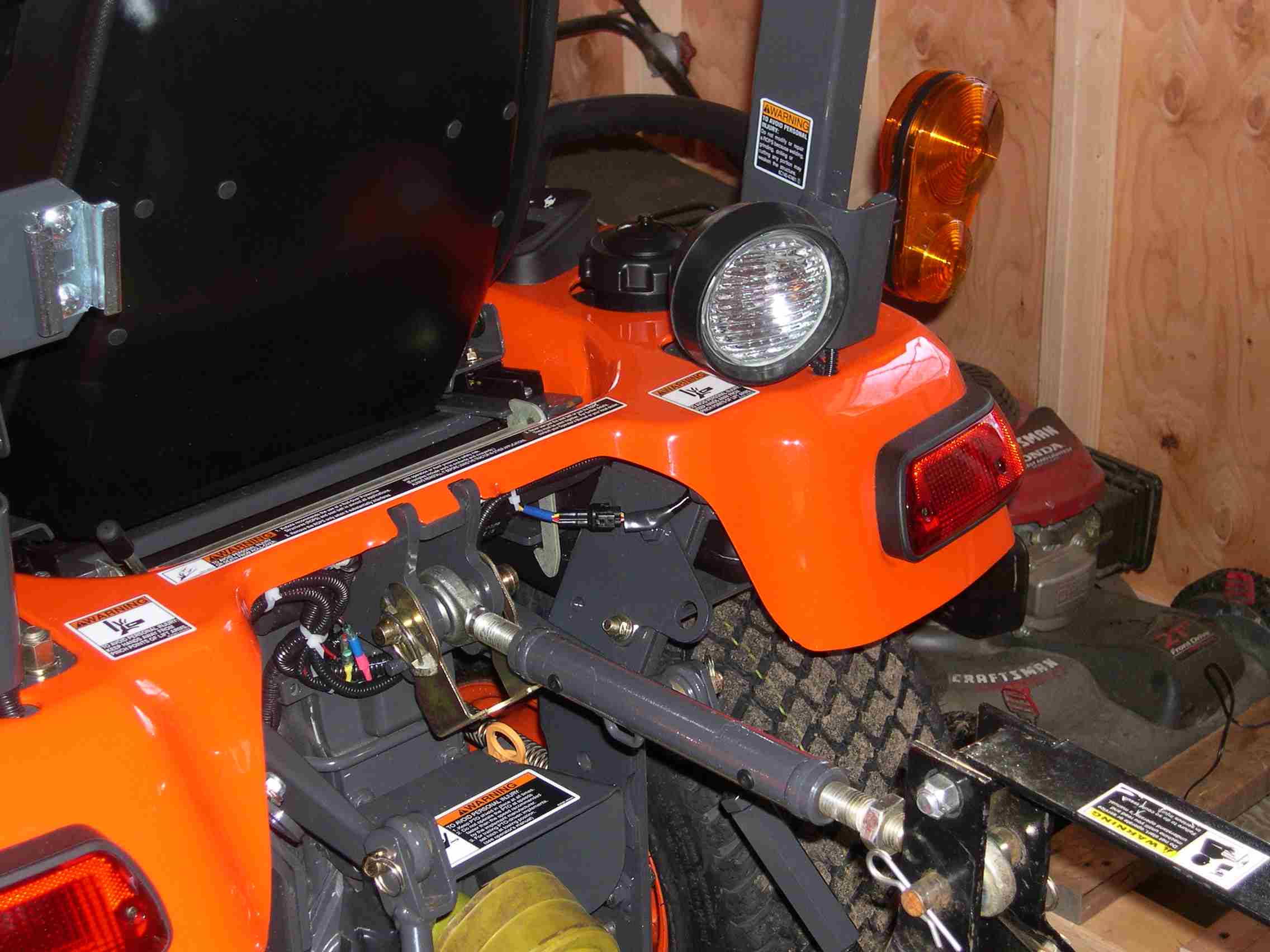

/ BX2660 Work light #2
The Kubota work light has a switch built in to the lamp. Works well and can be mounted in multiple locations. If I remember correctly the cost is about $60. Shown in picture.

/ BX2660 Work light
Thanks, for $60 I will check into it. Kubota equipment is always safer if there ever is a warranty issue with wiring. I really expected twice that much. I see 55 watt halogens for $11 but did not have built in switch.

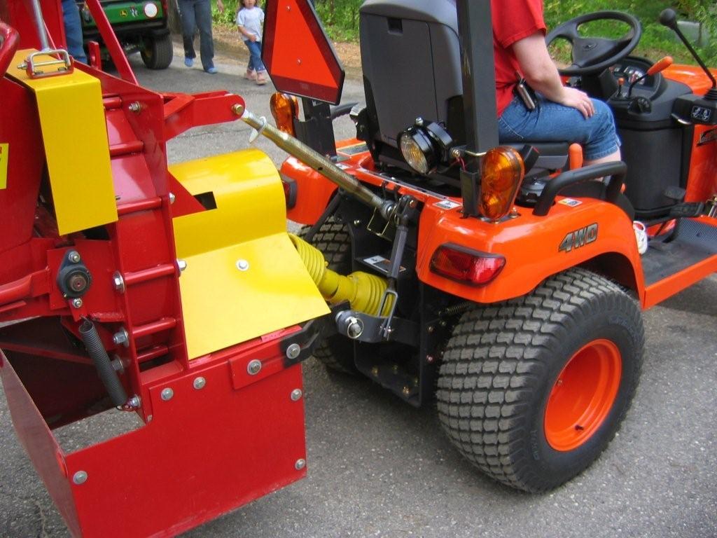

/ BX2660 Work light #6
I'm not sure if the one I bought would work for yours, but it sure does the job and mounts up nicely.

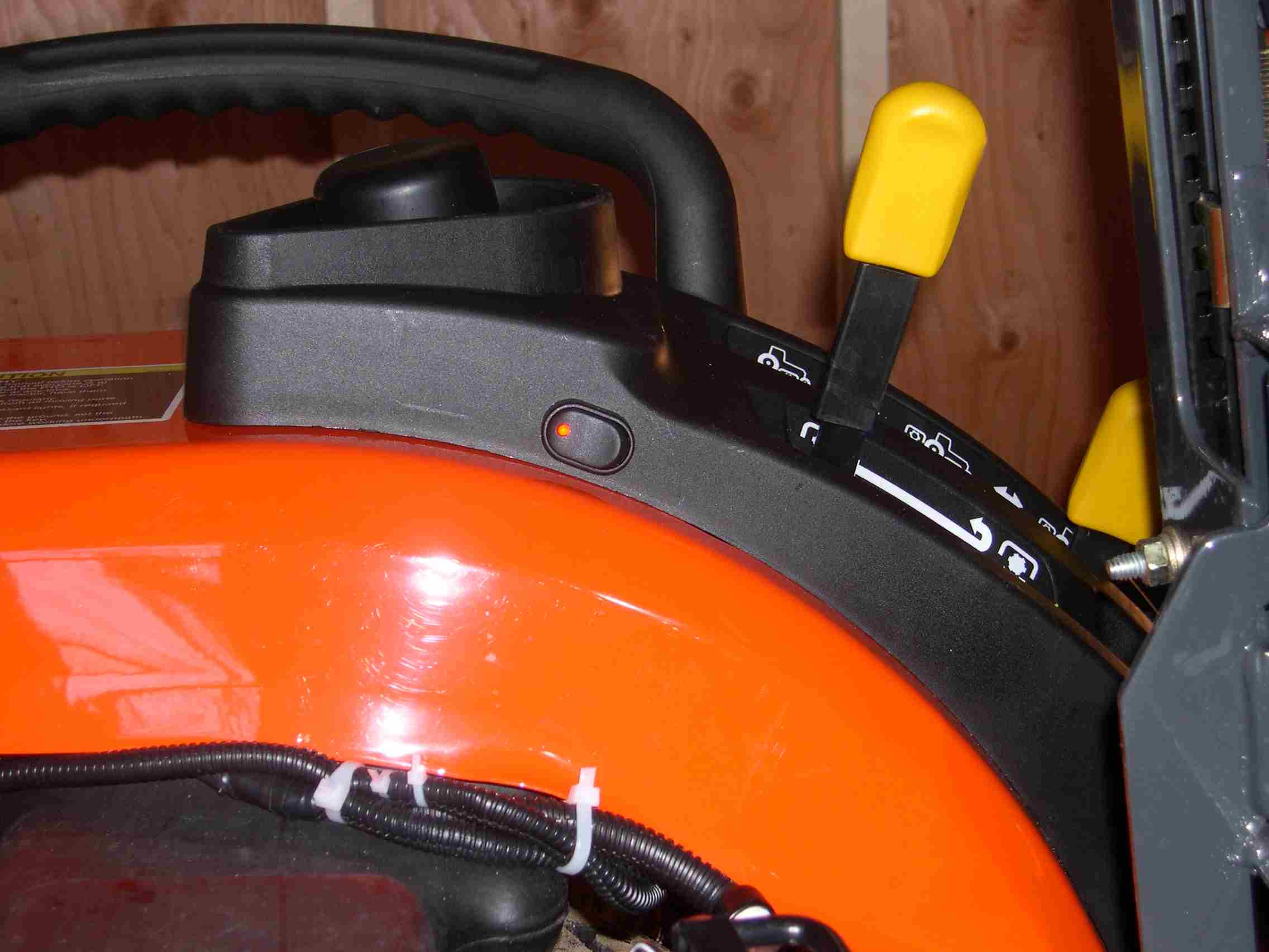

/ BX2660 Work light #7
Here's where I mounted my switch for my rear work light. I bought a cheap $8 work light from Harbor Freight - actually bought 2, one for backup. It works fine. The only thing cheap I can see about it is that it does not come with a ground lead. The metal mounting base on the light acts as the ground.
Tim, do you find that you use that storage pocket on the back of your seat?
/ BX2660 Work light #9
Yes, use it for work gloves and a couple of tools for the three point. It appears that it was designed for manuals or the like. Those are kept in the garage. Not too useful with out tools.

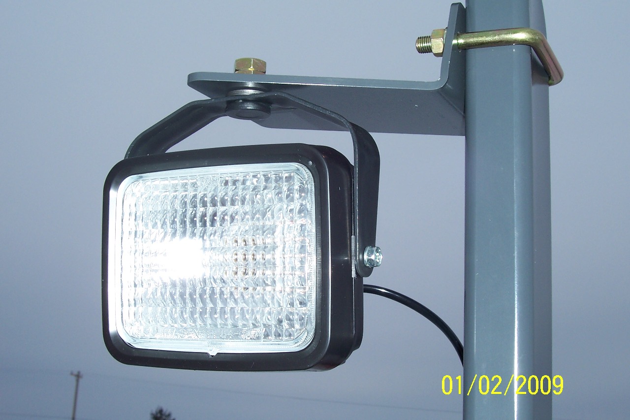

/ BX2660 Work light
I like all the options and different setups given. I like the U bold clamp and bracket setup on the ROPS.
I would prefer a switch on the light caseing making it one self containd unit that requires no extra wiring runs or modifications to the tractor. I could install a switch in a light but I can not find a weather proof switch. Looking for a push button on/off switch that has a rubber bulb cover.
/ BX2660 Work light #11
