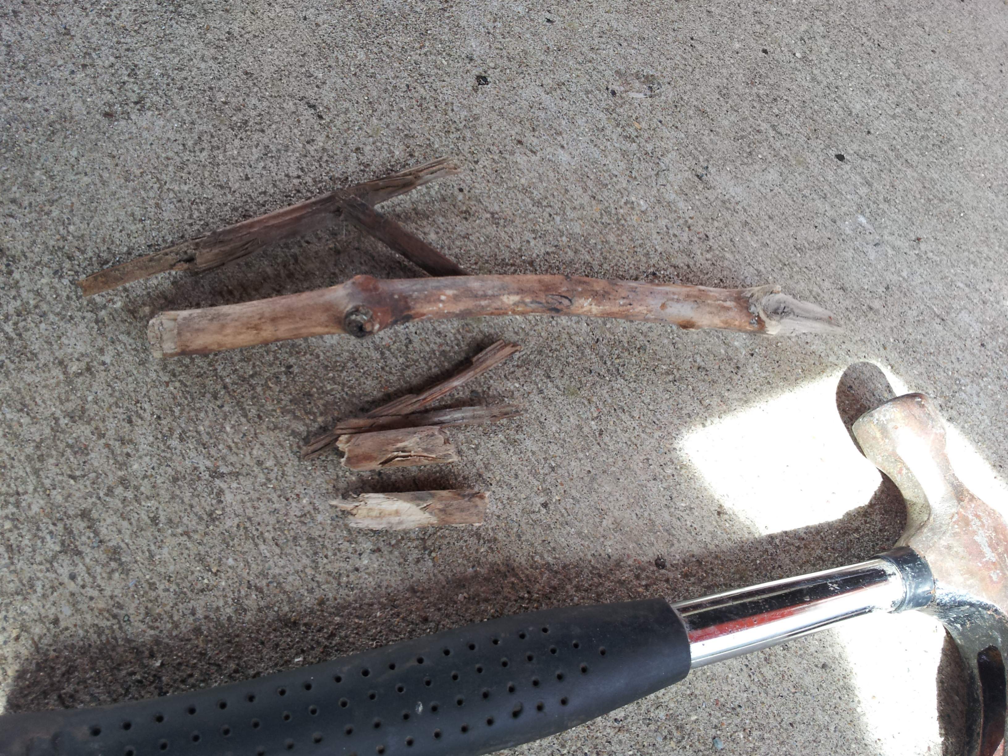

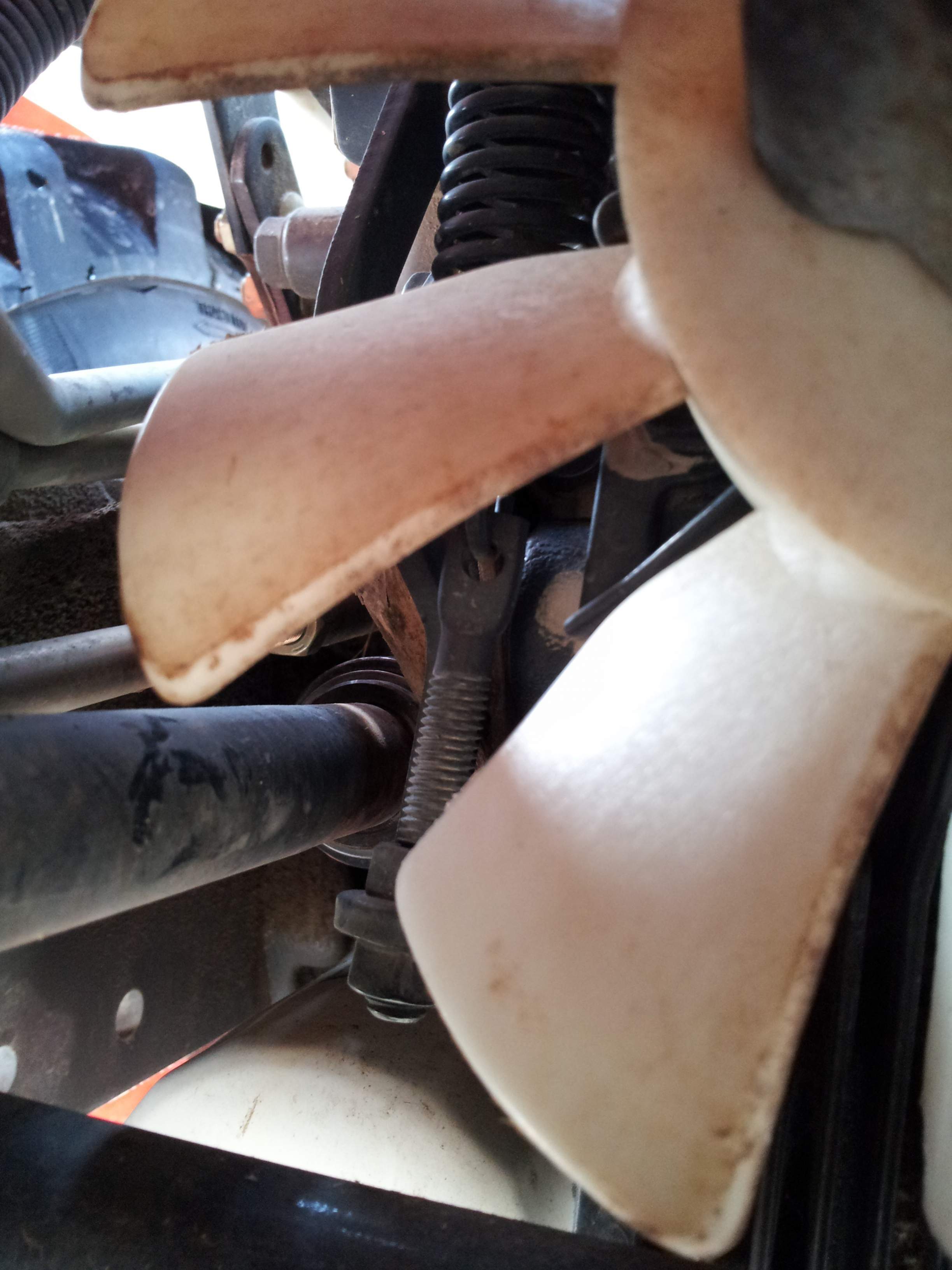

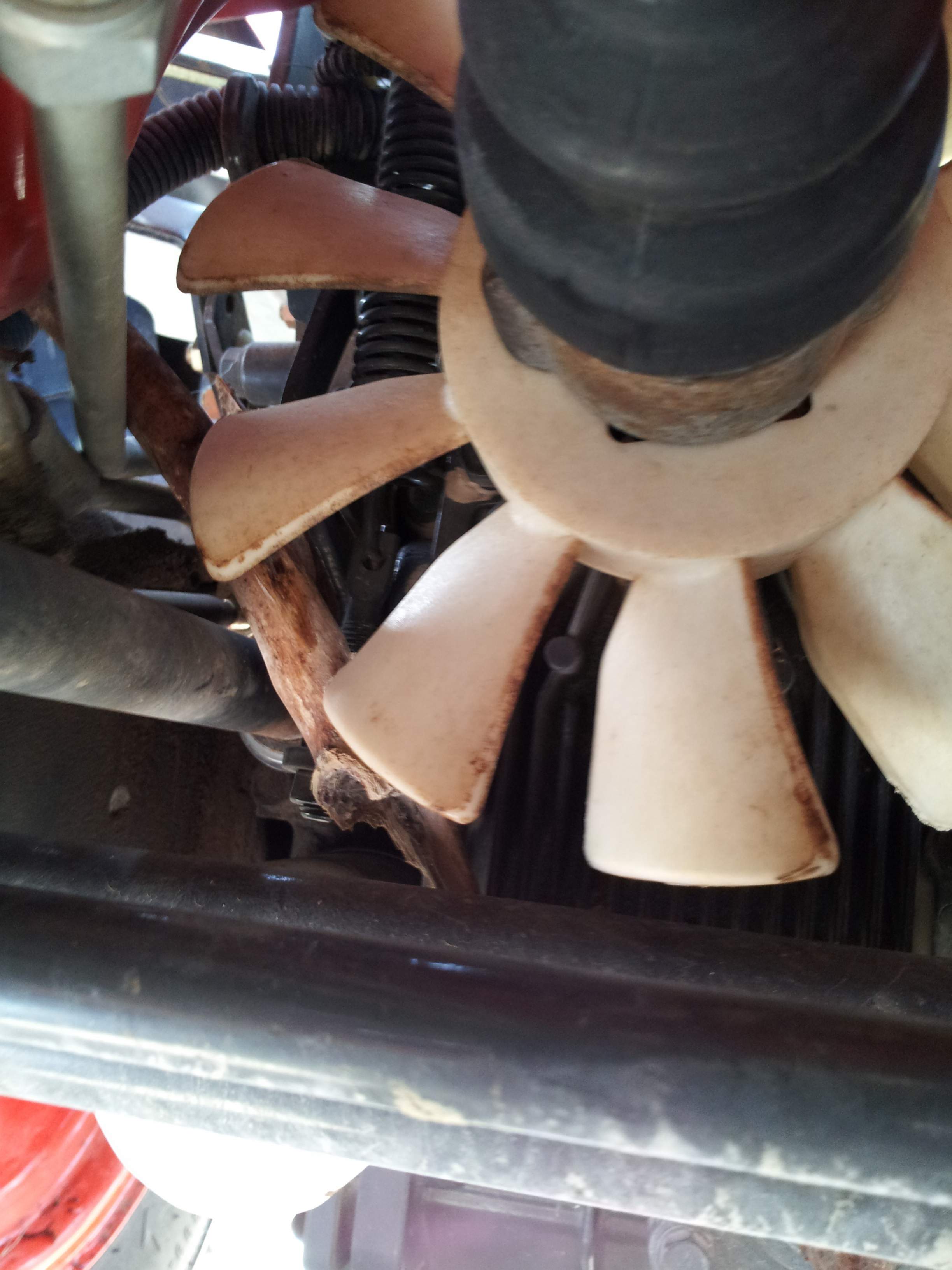

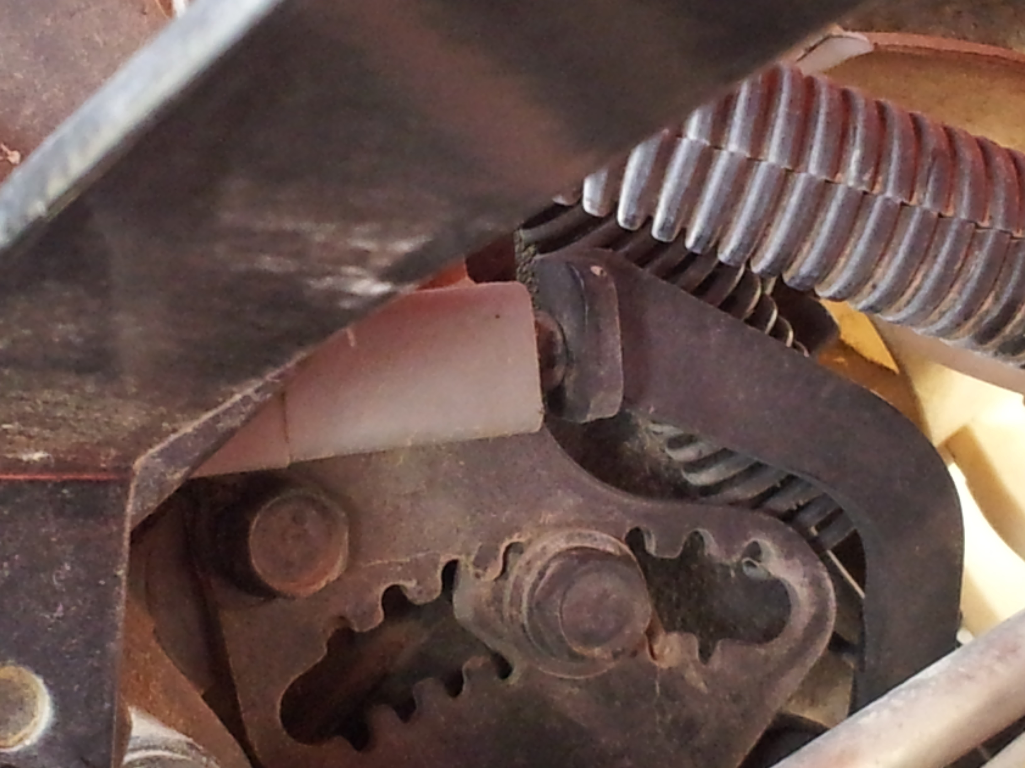

I got underneath the tractor and believe I've found the culprits. The seat switch seems fine, but some branches had worked their way up by the HST fan and looks like they were holding a contact switch next to the fan open enough to prevent a good contact.
In the first pic, you can see the largest stick on the left. Just behind the stick is a spring running straight up to the curved, not quite L-shaped, metal arm that connects to the white plastic encased contact in the center of the fourth pic.
The second pic is another view of the spring which is attached to a bolt. That bolt, when under tension of the spring, holds up another metal arm.
The third pic shows the culprits I removed next to a hammer for size comparison.
I've since been able to get on and off and start and stop the machine with not trouble. :cool2:
