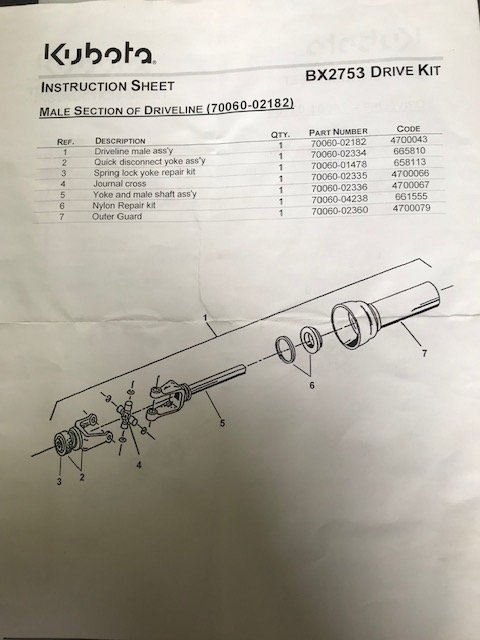

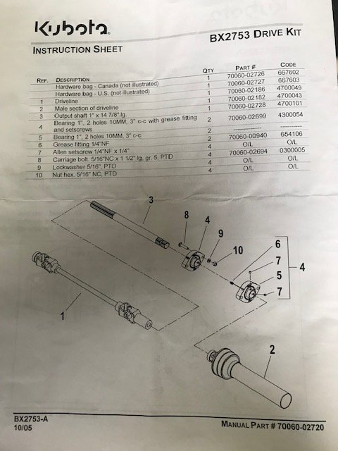

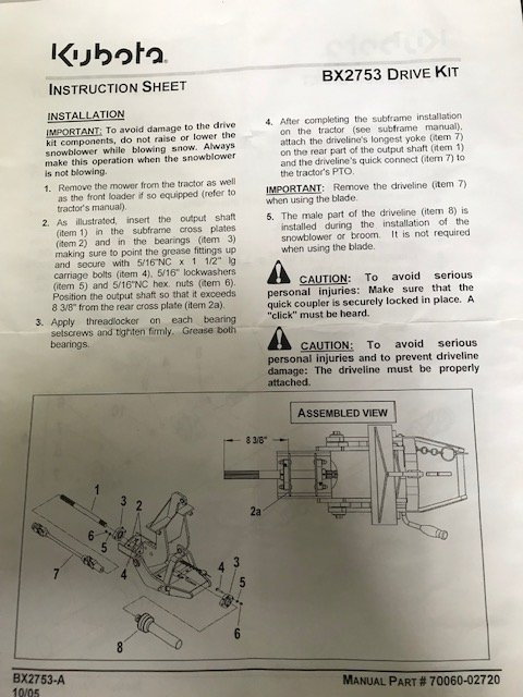

Who has one and what is needed for installing on my BX25d?
Dealer in NH is all over the place on what mods are needed to tractor for this installation. From what I can see in the manuals, the parts that go on the tractor (bx2751 subframe) and (bx2753 mid PTO KIT) just hang on the frame with pins…then you drive up to the blower and connect the driveline.
Dealer says it’s a “complex subframe install that takes hours to install”
What am I missing?
