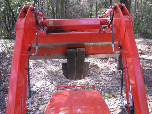

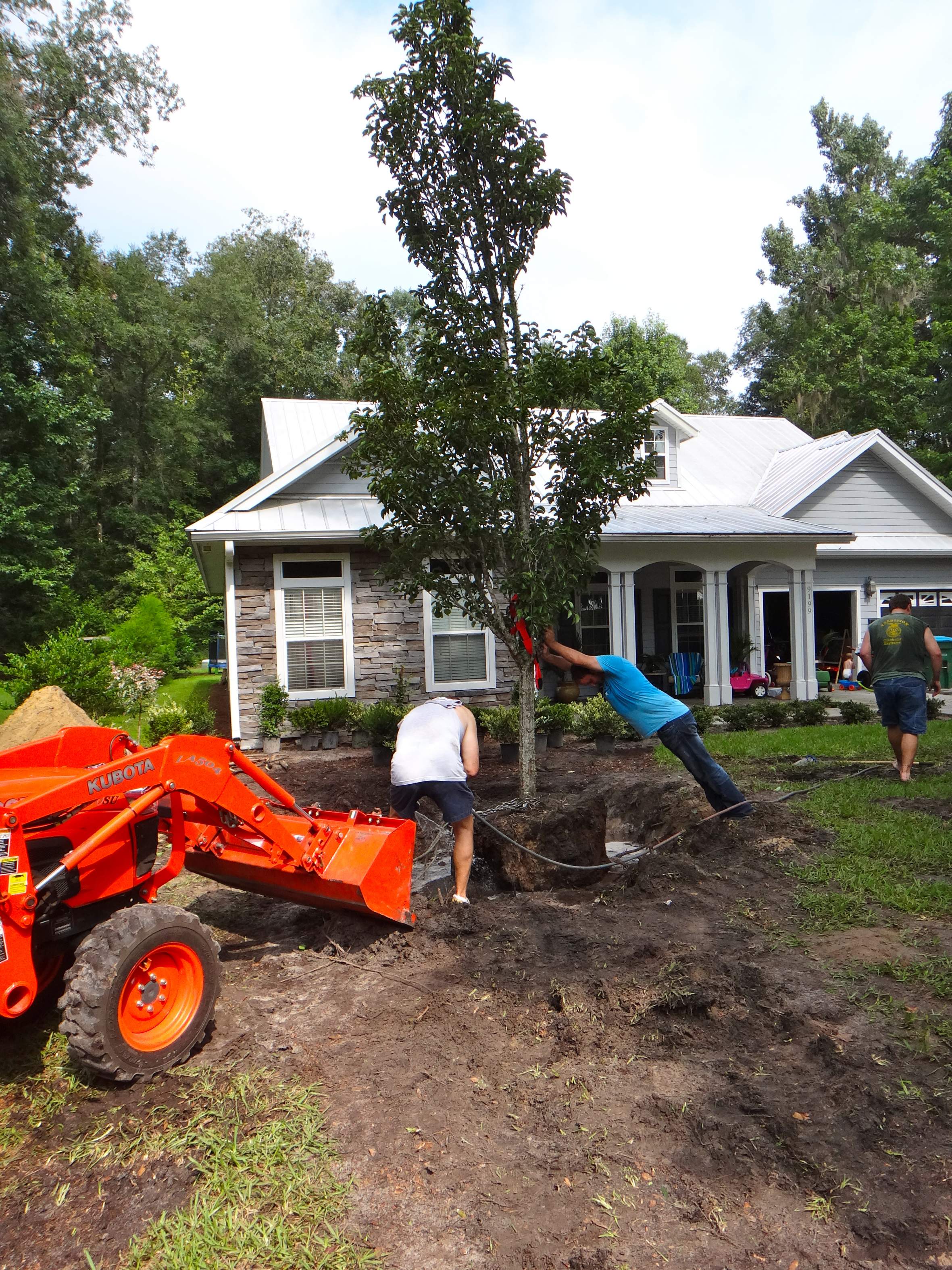

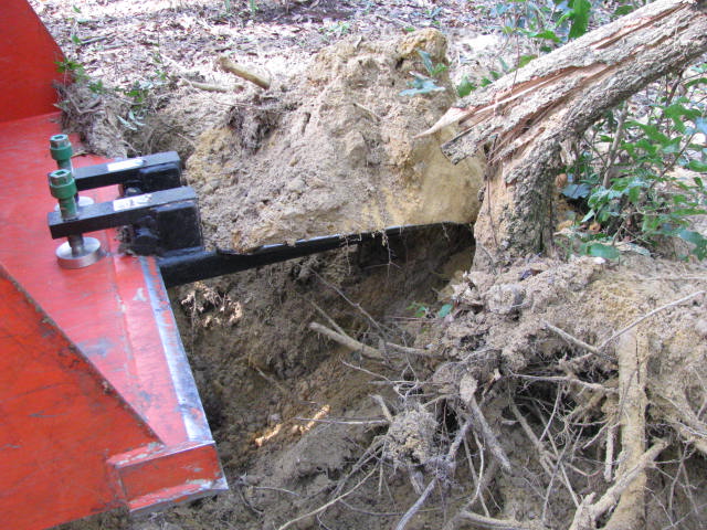

Have you considered a <$400 Bucket Spade in lieu of a Backhoe? It is a pretty capable bucket attachment.
Bucket Spade attached to FEL + Box Blade mounted on 3-Pt for ballast and filling excavations is an efficient combination.

Interesting tool Jeff. I'm not sure that would fit my needs but looks great for someone who wants to do some planting. How does it cut roots?
It weight 100+ pounds and comes fairly sharp. Cuts softwood roots easily. Hardwoods, such as Oaks, to 2-1/2" diameter tree.
If trenching is the main task, consider Ratchet Rake's "Rip and Dig". Variation on same theme.
