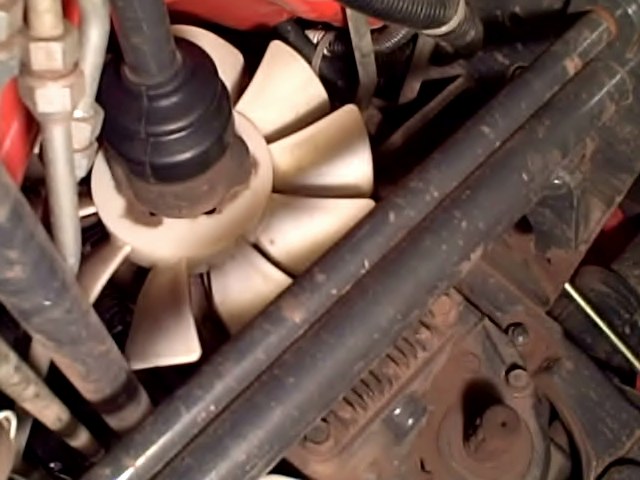

Here is a photo of the fan with the mower deck removed. It looked like it was tucked up in there, but so many people say it gets busted all the time so it just must be a magnet.
Kinda a bad photo, but hopefully you can get the idea. I could tell that if you did get the fan busted it would be a big bucket of pain in the ***** to get it fixed....tons of stuff you have to take off.....looks like it would be labor extensive.

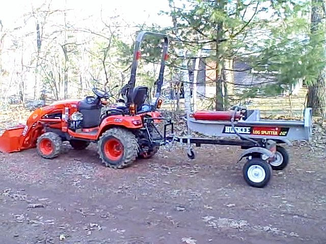

He's a shot of the fan on my BX-25. If you go into the weeds, you best get this thing covered.
Is that on a BX-25 or a BX25D.

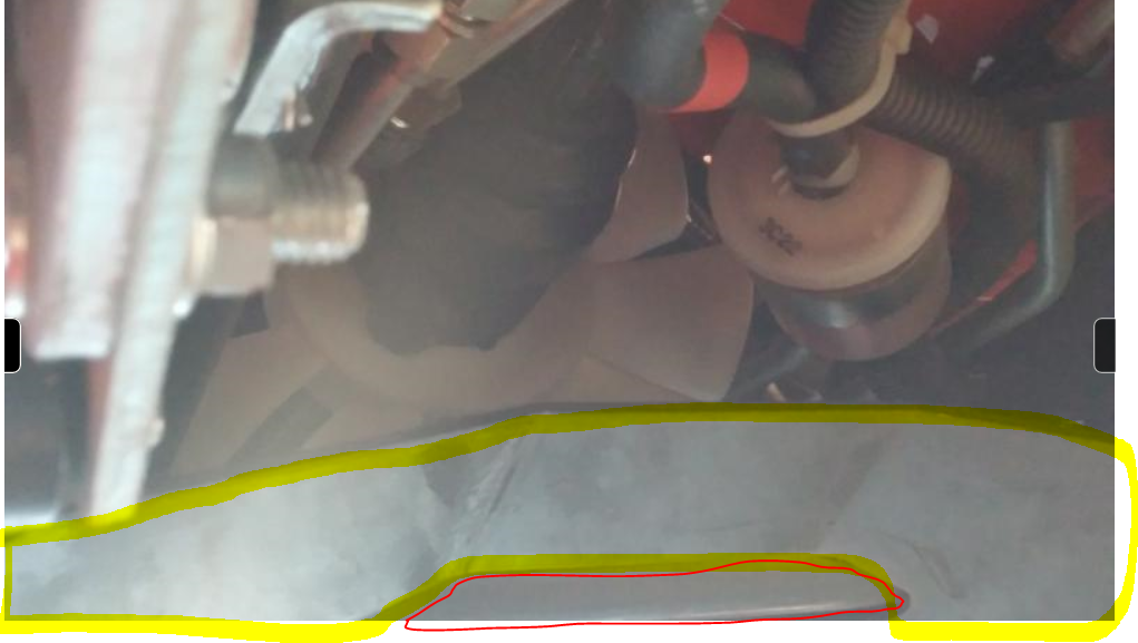

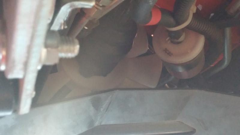

On my new D there is a large metal "pan" that is right under the fan. On this photo I outlined the pan in yellow, and I am thinking that the long "tube" sections you have I did in red.
Now you have me real interested....I am going to climb under the thing again tonight and try to get a better pic.

I've got a 2010 BX-25.
I posted the year wrong: it's a 2008.

I had read so many threads on this fan issue that after I took the deck off I wanted to take a look. I was thinking now how in the world does something get up in there and busts that fan....but so many people have issues with it, the fan just must be in the right spot to catch everything.
I am not sure my lift can get the machine all the way up....the tractor is pretty small, but at least I will prop up the butt end of it and snap a quick pic. I am real interested if this is something they added to the newer D machines, and wonder if other D machines have it or if this is like a mid model year change.
