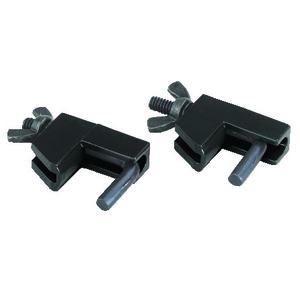

Amazon.com: OTC 4506 Fuel Line Clamp Set - 2 Piece: Automotive
[edit] Forgot link to fuel hose pinchers.
