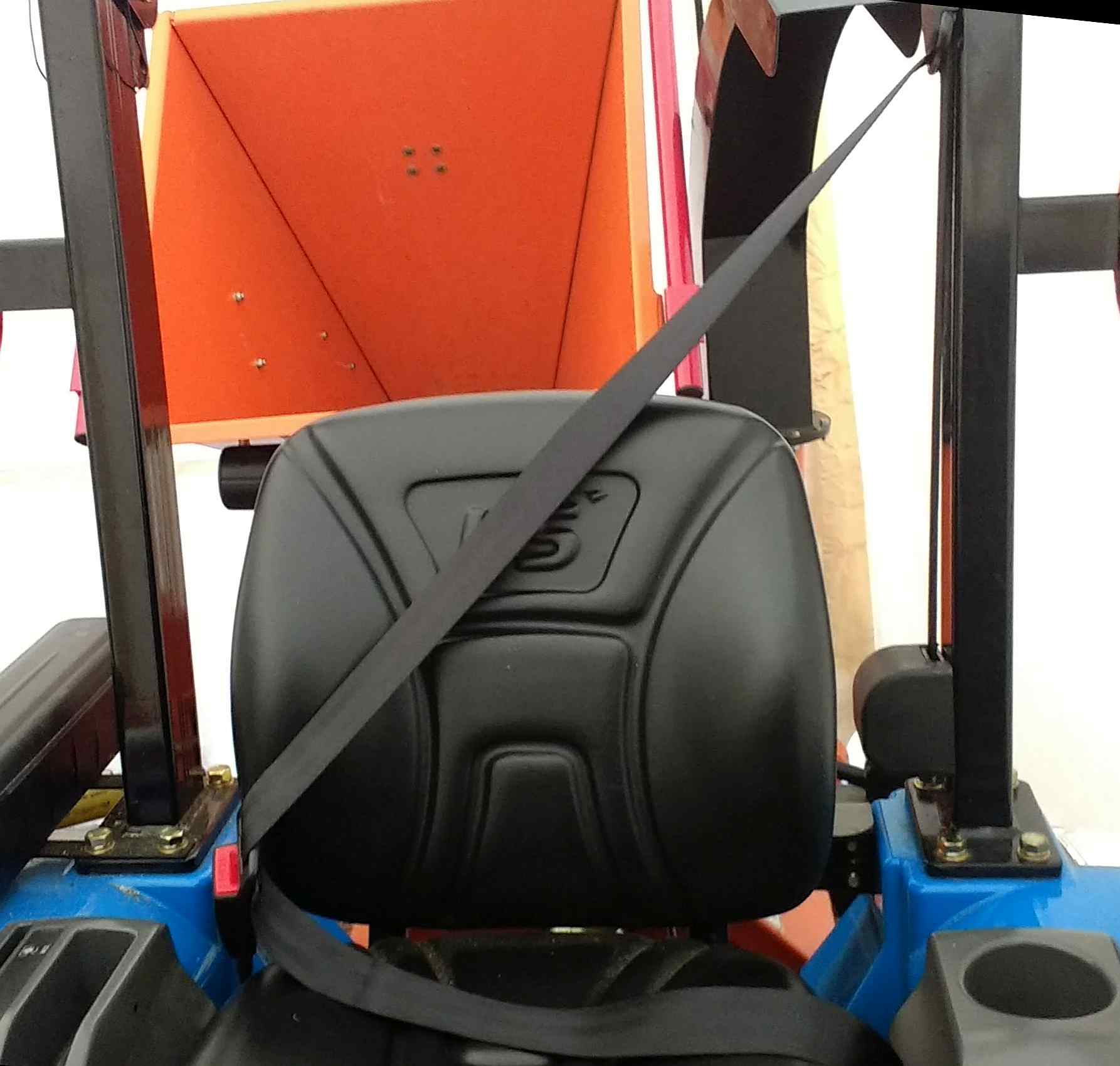

It appears that this belt is ideal for replacing the non retractable, "lap only" belt on our LS tractor to work with the ROP.
Amazon.com: HexAutoparts Universal 3 Point Retractable Auto Car Seat Belt Harness Lap Shoulder Adjustable Safety Belt: Automotive
Not only that, in addition to being the best apparent replacement, At $23 it was the least expensive option that I found after a lot of searches both here and on the web in general.
The LS also had straps all the way to the anchor points on both sides, so the stiff cable mounted latch solved the problem of always fishing around to find the buckle and was the perfect length to boot... it was necessary to bend the mounting bracket on the buckle side to orient it correctly.
Note that the included bolts are metric and only one metric stop nut was included, so, in this case, I had to substitute an equivalent SAE bolt and nut.
Using it for a few days feels much more secure than the lap only. My main question would be if there is any hidden danger to using the 3 point with an ROP.

Thanks... after years of flying, I am well aware of the fabric degradation issues.
imho, it's more likely that the retractor unit will fail from corrosion or dirt, plus, in my case currently, the tractor is out of the sun and weather when it is not in use.
fwiw, I am really happy with the install... in addition to feeling much more secure when strapped in, it is now far easier to put the seat belt on and, when retracted, it is completely out of the way.
