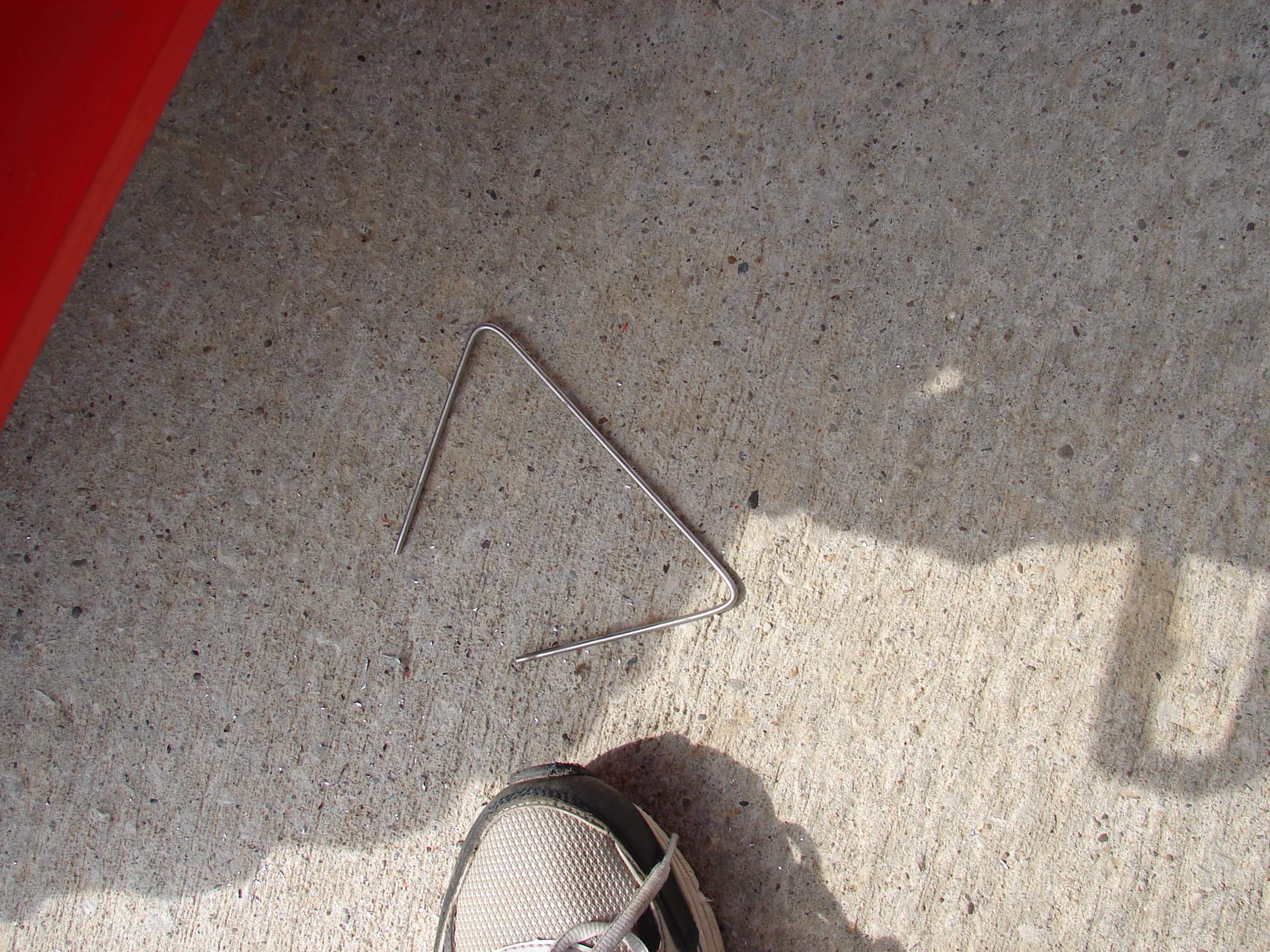

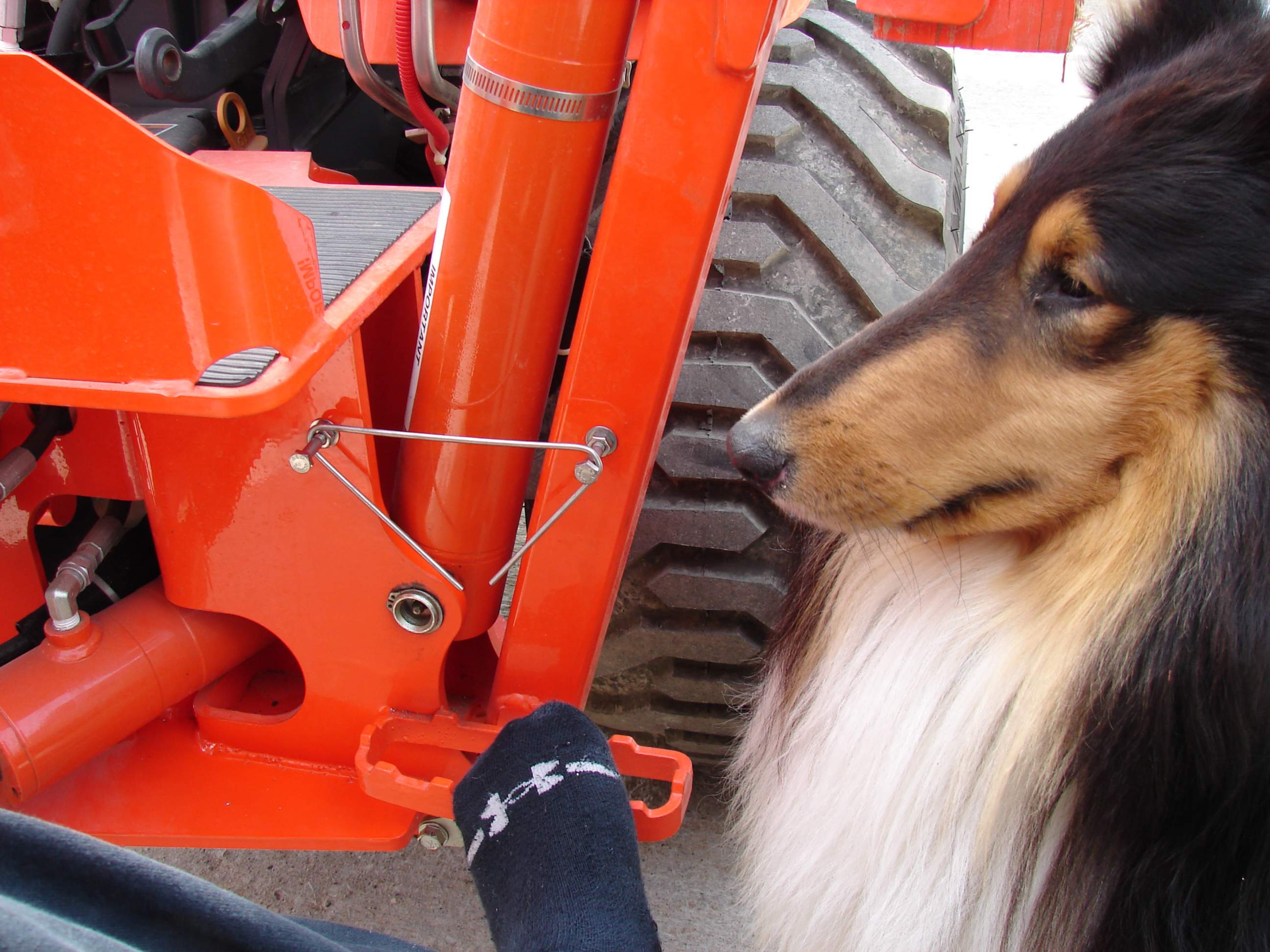

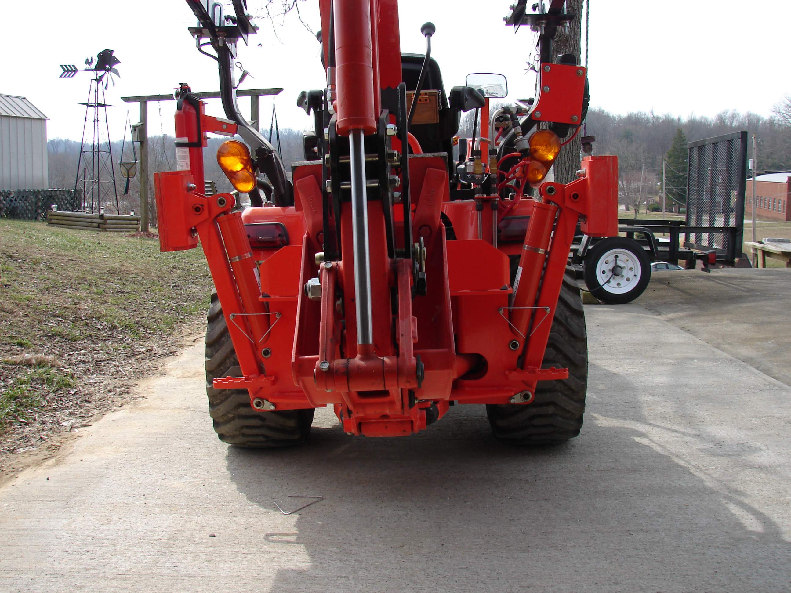

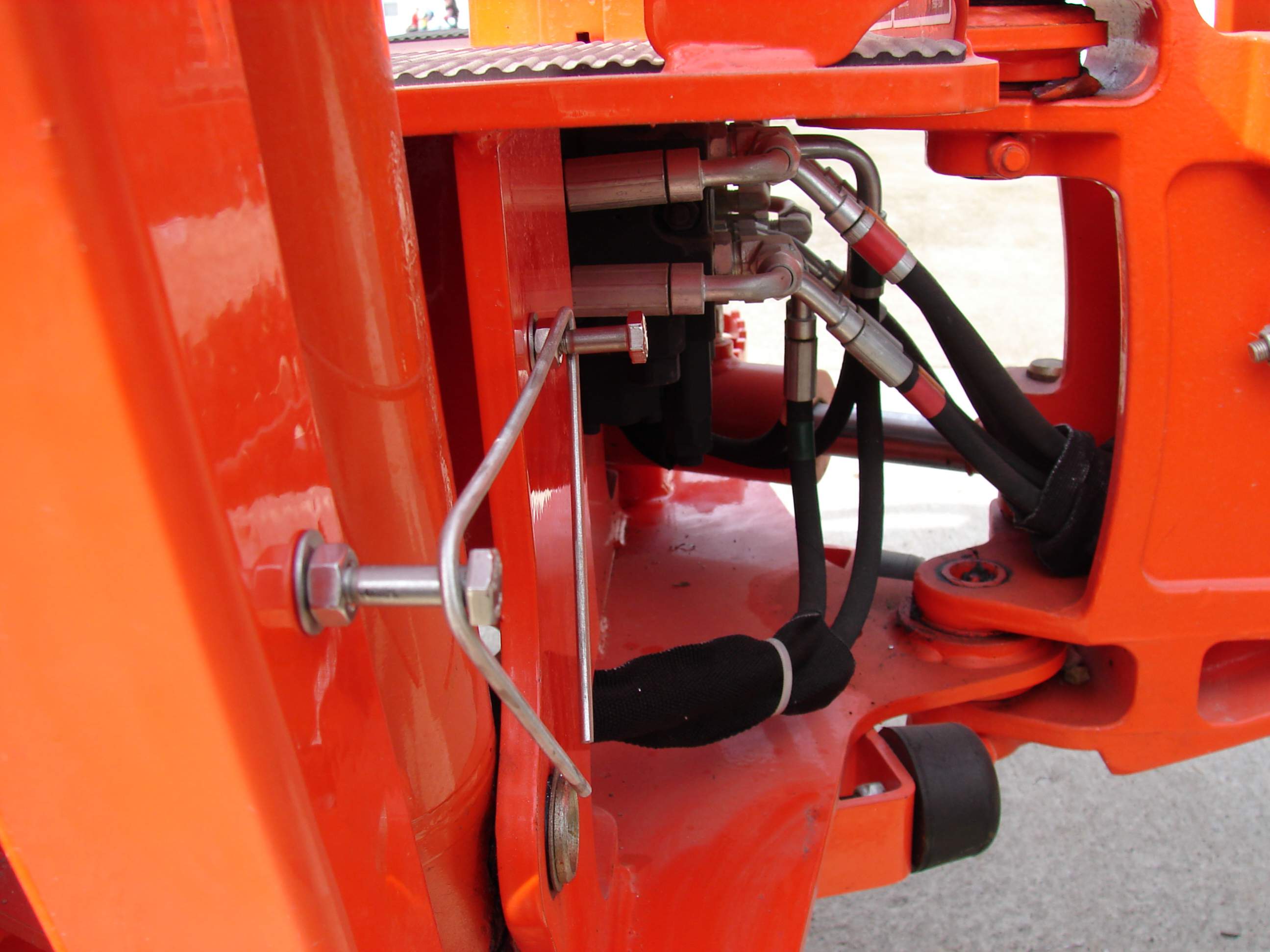

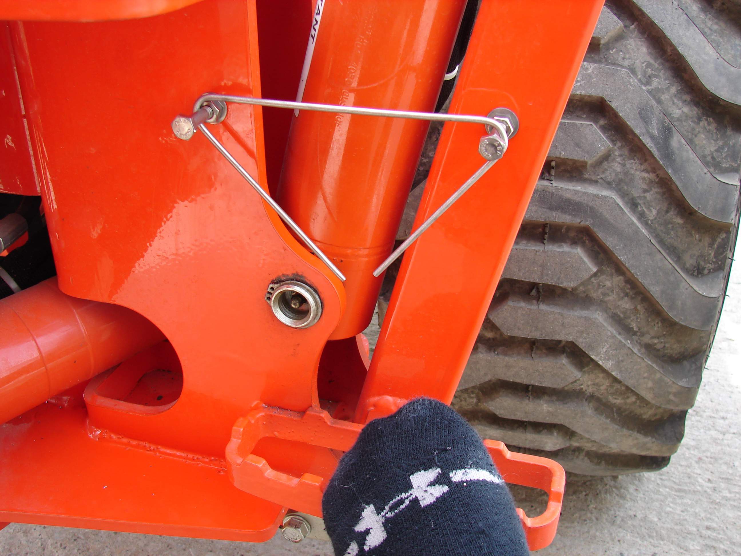

I am tired and the bungie cords are tired of holding up my BX25 outriggers. Over time you all know they droop and land on the floor. . If you forget to look at them, they will drag when you take the 25 out, not good. I have my solution. No more drooping out riggers. So I made these retainers out of 316SS 1/4" bolt hardware and 316 SS - 1/8" weld rod and if you forget to remove the retainer wires, they simply stretch out and fall off ( tested it ). So on with the new Tachdriver Mod..........:thumbsup:

Pretty neat! AND it is Collie approved:D
/ BX25 drooping Out riggers
Yes sir, that Shadow, he is inspecting it and gave me a barks up for approval !

Thats a good idea, I have to come up with something also for my Bh92. The kind I made for my B3030 won't work on that.
You could just bend one end around the bolt on the frame so you won't loose them.
