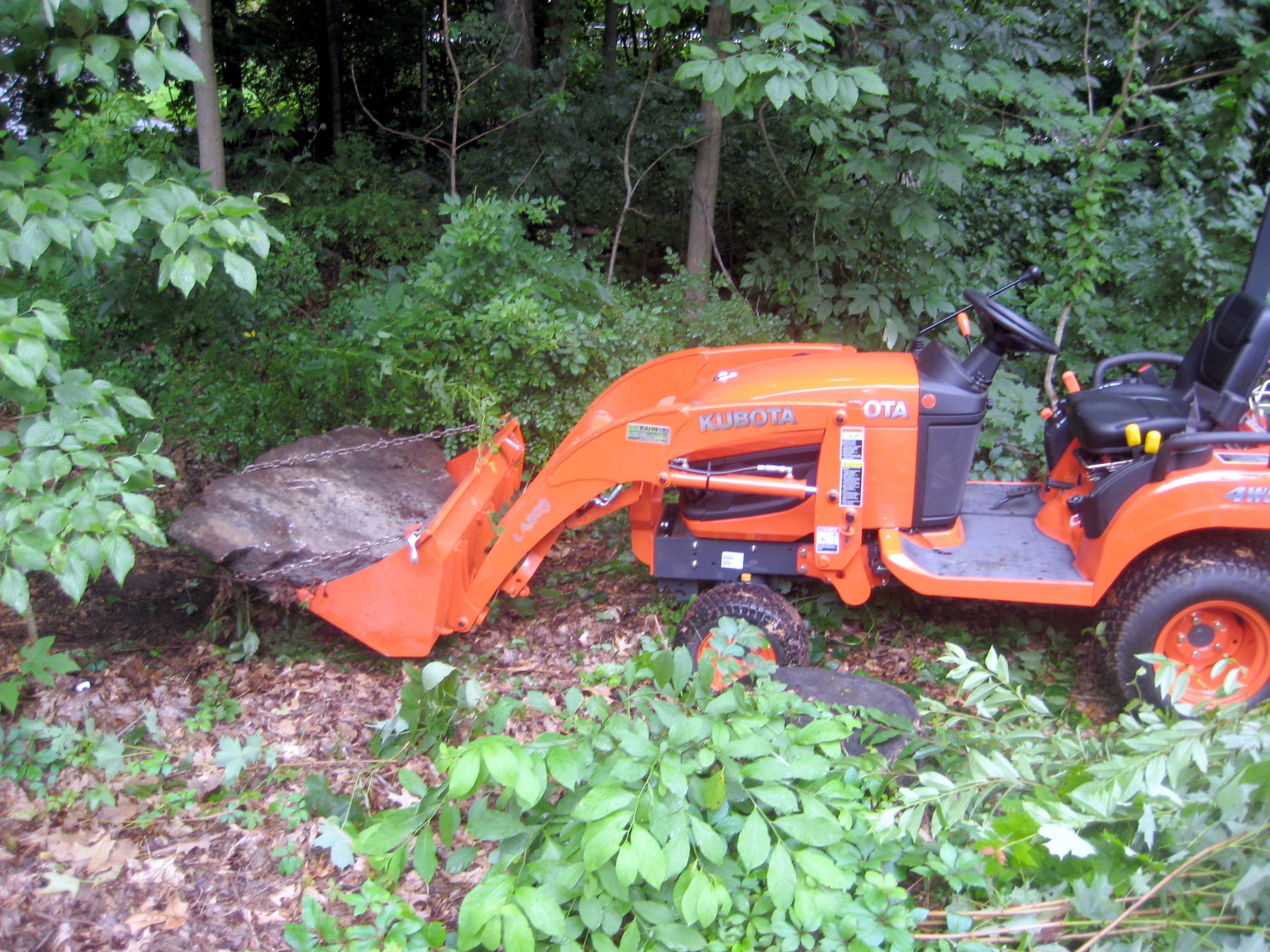

I think that's because having chain hooks added to your bucket is almost standard fair for TBN guys. I had mine done after reading here and elsewhere how helpful it is to have hooks on the bucket. Mine are at the outside top corners and don't seem to need any additional reinforcement.
Here's how I use mine most often, which is to use a quarter inch chain from one hook to the other to help keep large objects in the bucket.
