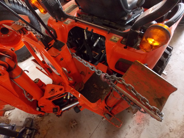

/ Bx25 backhoe sags when parked #3
Yep normal. What frustrating to me is during the storage of my BH off the tractor and on a dolly, the stabilizer feet slowly deploy making the BH bigger and harder to maneuver around. Have to connect up to the tractor to raise them up. Careful that you don't park the dolly such that it gets trapped because the legs sagged. I am now using some long cabinet making clamps to keep them upright. Tried some cheap zip ties and they stretched and broke.

/ Bx25 backhoe sags when parked #9
i use a cheap rathet/binder strap or heavy duty tarp straps - they work great to keep the stabilizers contained.
/ Bx25 backhoe sags when parked #10
I think the technical term for this phenomenon is called "creep." The pic will show you how I dealt with the creep on my stabilizers in the garage.
