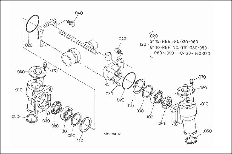

I was just going to post the same question. I have a leak between the bevel gear case and front gear case on my B2910. I looked at the shop manual and it looks like there is an O-ring between the 2 parts which are held together by 4 bolts. It looks like an easy repair. Not sure if the BX24D is similar. I am curious if anyone has attempted this repair.

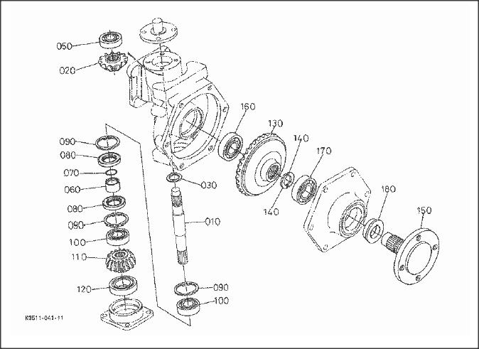

I did axle overhaul on my F3060 mower due to oil leak and preventive maintenance (3500+ hours on the clock). Couple new of bearings, seals and O-rings etc.
I did not need to open the differential, only the pinion seal & bevel gear housings.
Similar design - lot of parts, but it's not rocket science.
Assuming you are comfortable working with gears & seals etc. and make sure you have the appropriate shop manual for your model tractor.
I suggest removing the whole axle from the tractor before opening it up.

Yes, It looks like the O-ring #20 in the first image is what needs to be replaced. I have broken and replaced both axles in the past so I don't mind attempting the repair. The leak is so slight that I wonder if going to a higher viscosity oil would solve the issue; I currently use 80w90.
