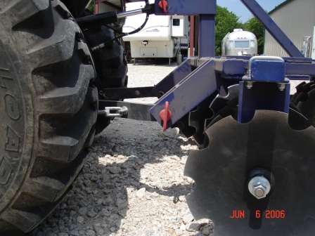

Today was the first time I have gotten around to trying the plow (http://bluebirdmeadowfarms.blogspot.com/2007/07/just-what-i-needed.html) on my tractor - or my brand new disks... (http://bluebirdmeadowfarms.blogspot.com/2007/08/while-concrete-dust-settles.html) with my BX24... up until today there were some minor things that bugged me - but it's been a more than capable tractor...
Here's the thing - neither the plow (not even at all) nor the disks really (about 2 to 2.5") even come close to engaging the ground... It's like the 3PT arms are too short... no amount of rolling out - or rolling in the top link gets things to bit into the soil...
I'm rather confused and frustrated. Especially since I KNOW others out there have plowed and disked with these before - using 3PT equipment...
I'm thinking I'm at a mental impasse - because - I know how to adjust a plow - and there is no way I can get the arms to lower far enough to bit ground...
Do I modify the plow and move the pins higher so it sits lower? Do I buy this - http://www.northerntool.com/webapp/...oduct_6970_200280774_200280774&issearch=12610 or this http://www.northerntool.com/webapp/wcs/stores/servlet/product_6970_7807_7807&issearch=12835 to get a little more length on the drawbar arms - so they hang lower...
I know I can't be the only person to have some implements not engage the ground with a BX... Help me TractorByNet... you are my only hope...

The most effective pictures you could post for us is a set of views with the implement on the tractor and the three point hitch cotrol in the down position. In this condition, I would be interested in seeing a side view of the implement (to include the rear of the tractor), as well as a closer view that shows only the 3 point hitch while the plow is down. These will enable us to give advice on what's broken or set-up wrong. You should achieve engagement without a problem and spinning those tractor wheels in no time.

OK - I just ran outside and snapped some shots... did not have time today to mess around with a defective plow... :)
First one shows (the red line) the farthest I can lower the drawbar... no biggie there - looks normal. In that first shot - the disks are still attached - plow is in the back ground. (also of note is the concrete block edge you can see on the disk - about an additional 200# on top of the disk - 10 passes on the weed covered ground and I'm about 3" deep...

/ BX24 won't "ground engage"? #15
You got some hard ground. You 3pt looks normal to me anyway. I have no idea on the plow set up since I have never had the pleasure to try one out...the disk on the other hand.... In my dirt I have been as far as 5 - 6" and my disk weighs 663lbs.

I'll take some more pictures tonight - but the arms all the way down look about the same as the picture with the disk on...

Greetings,
Do you have the lift arms on backward?
I'm not familiar with your tractor but it looks like the lift links are laid down a lot.
Can you reverse the lift arms and make the lift links more straight up and down?

Thats exactly what I was going to say. On my BX22 the arms will go on backwards and bind up the three point. By backwards we mean that the knuckels that should connect to the implement are in fact connected to the tractor.
/ BX24 won't "ground engage"? #20
Ditto what Volf said.. unhitc and see where your 3pt arms rest in full down position.. look at the implement pins..how much higher are the pins?... the difference in those is how far the plow will be allowed to go. the rest of it is toplink for angle, and sidlink.. etc..
