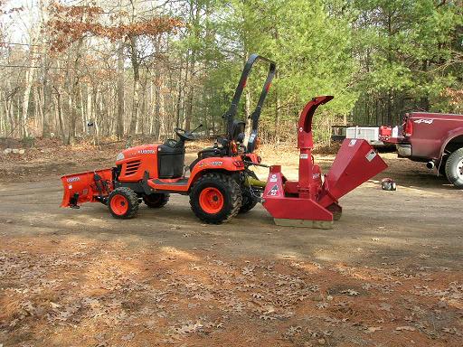

Yes, I run a Wallenstein BX42 chipper and the tractor handles it fine. I can run it to chipper capacity with out any power issues. Just check the weight /physical size of the chipper those will be the limitations of a 4" chipper.

Weight seems to be close the BX42 model at
403 lbs (183 kg)
