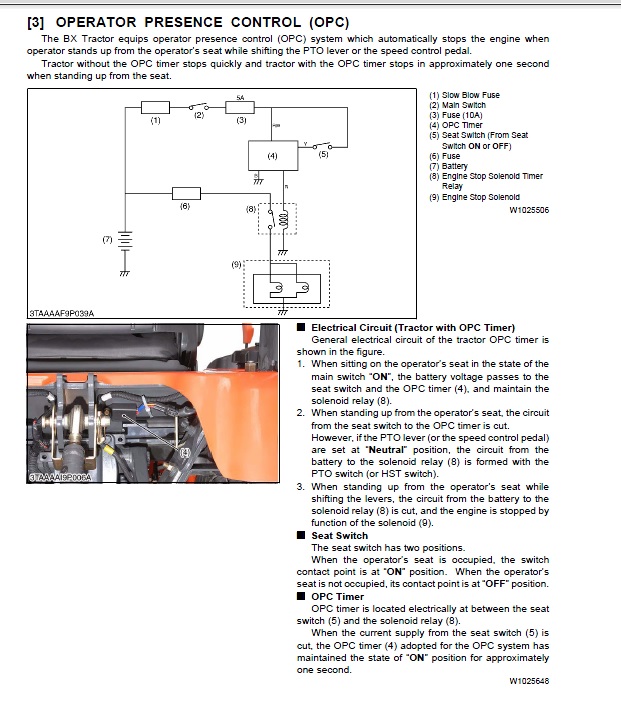

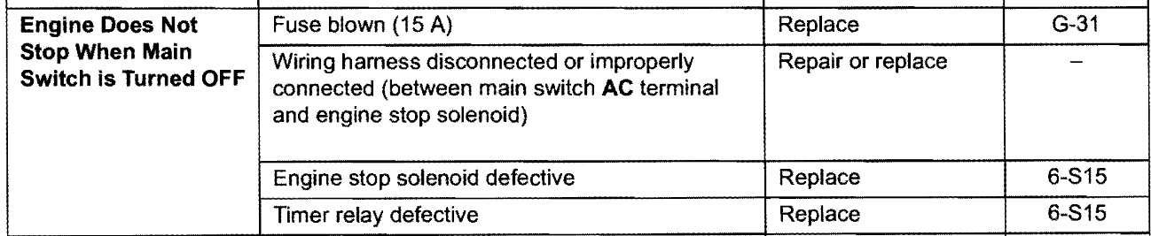

Contrary to what would seem logical, your machine has an Operator Presence Controller which sends a timed pulse of power to the engine stop solenoid to stop the engine.
First check all fuses as one critical one means there is no power to stop the engine.

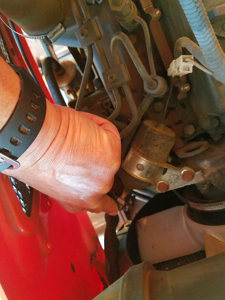

You can reach the solenoid on a '24 by just lifting the hood. No need to remove anything. Rear of engine compartment on the left (from driver's perspective) and below the air filter. Just push it in.

So, since I started this thread, thanks for all your responses! Besides killing it with the brake/HST combo, have learned also to manually kill it by moving the speed control plate in the engine compartment.
Today, finally took the stop solenoid to the dealer - asked the parts desk to test it - of course, he came back and said it was shot. (can't help but feel like the classic fox/chickenhouse...) anyway - still need to learn to do that type of test. Found an older thread from 2007 with diagrams for that.
Installed the new solenoid. still didn't shut off. Checked the fusebox a second time - the 10A fuse for the timer relay was broke. replaced that and so far, has now shut off at the ignition 3x now. like old times...wooo
now, the next question please: the solenoid rubber boot on the wire end includes a "tube" about 1.5 inches long at 90 deg to the body. The old solenoid, this was full of crud/dirt. So - is it correct to assume that this does NOT connect to any thing? Is it a breathing or heat dissipation tube or ?
   / BX24 - will not shut off. How to choke? #20
That boot should be covering the push pin to manually shut the tractor off, I think the tube is to let air in and out so there is no suction if you push the pin in to control the rack inside the IP..
