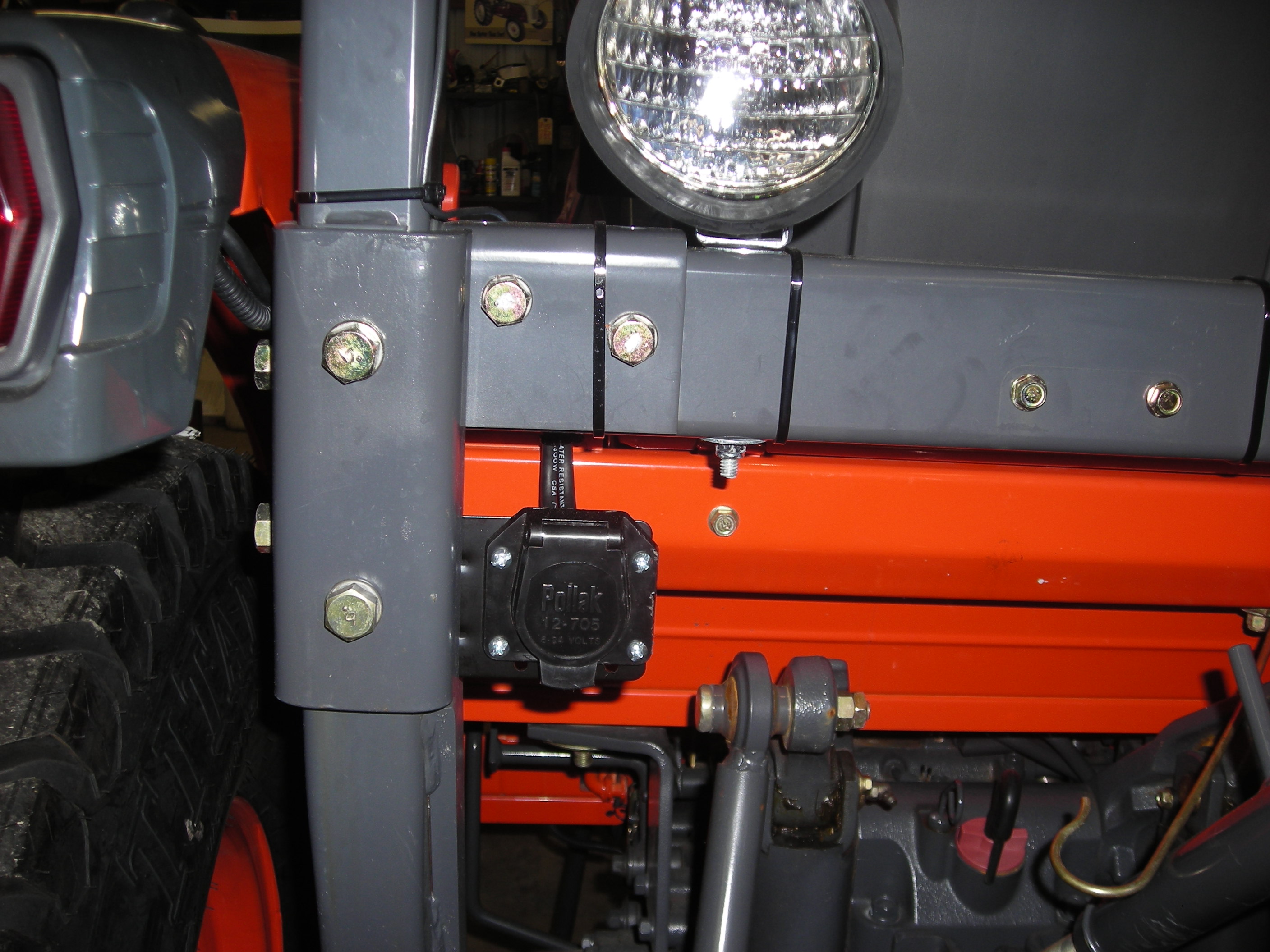

Has anyone ever installed a trailer plug on there bx24. I'm thinking of adding one but not sure if I should go with a 4 pin flat or a 7 pin. I would use it when I'm pulling my 2 trailers, also if I go with 7 pin I couild use it to power some rear mounted atachments. If anyone installed one on the nx where did you mount it?

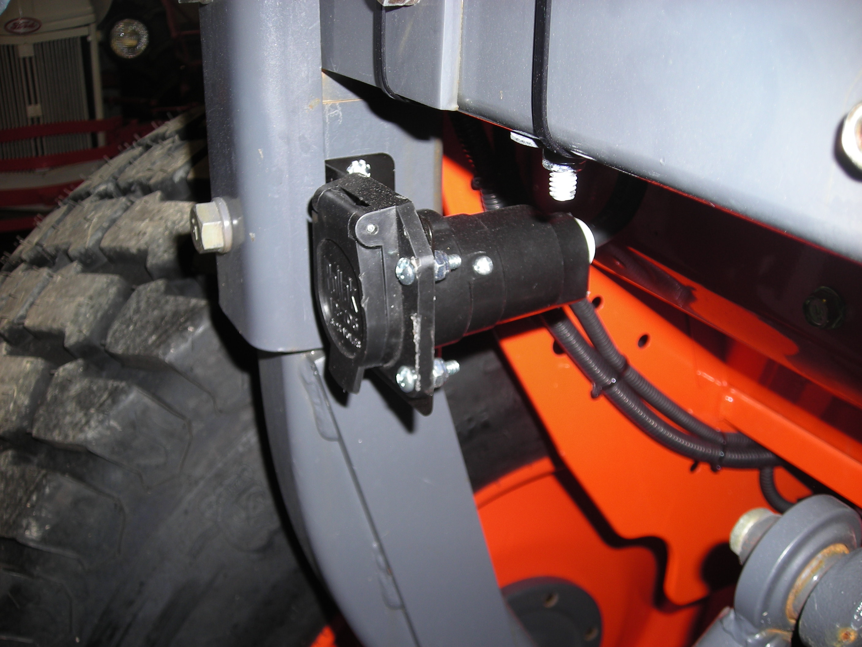

Here is a 7 pin on my L3940, yours could be similar. Philip.
