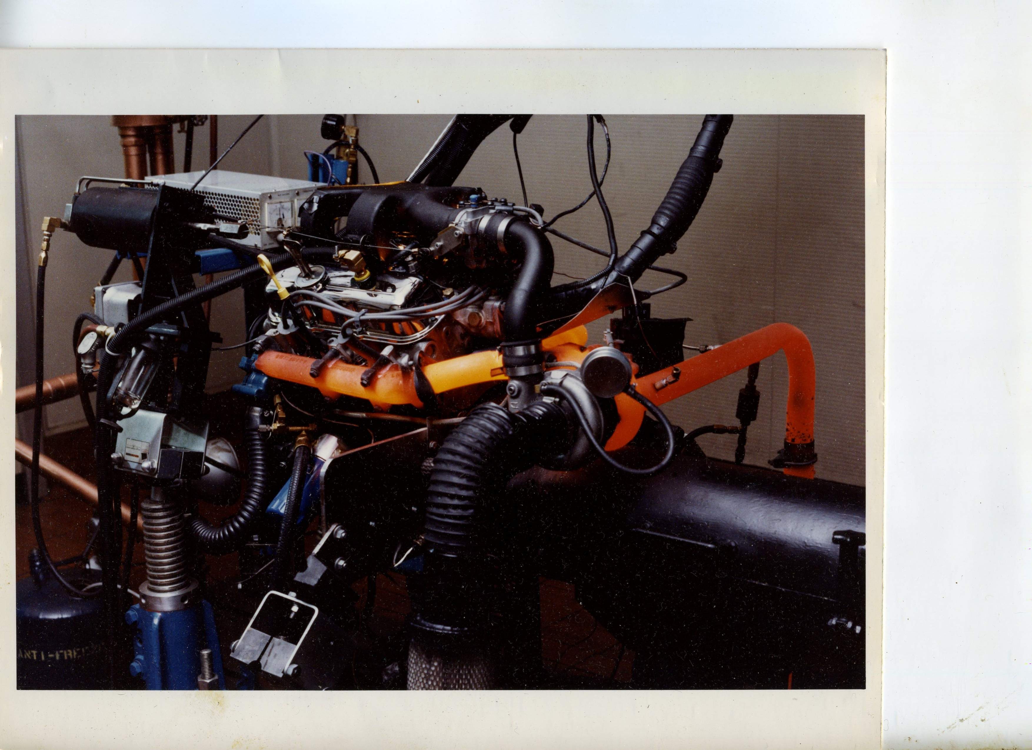

Came across a cool pic from 84' of a aluminum 2.8 liter putting out 300hp. When we all jumped on turbos for power out of 4cyl. economy engines.:D
