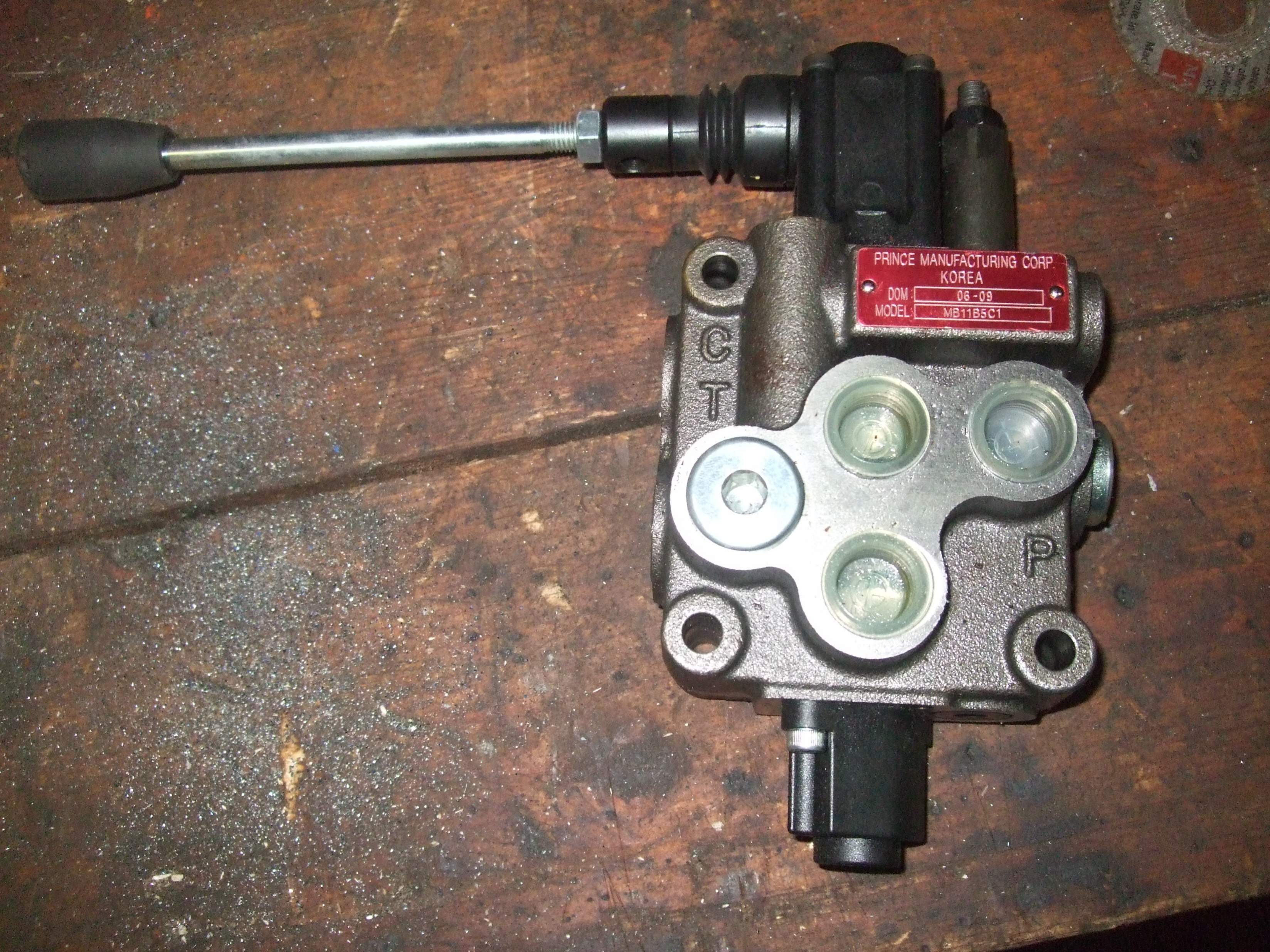

I am on the same journey so to speak. I went to my local hydraulic store and bought a prince MB model single spool valve. It came with a power beyond plug so I can still retain the use of the 3 pt at the same time. I havent gotten the hoses yet, but I am contemplating on making it with steel hydraulic hoses for permanant connection, but still can disconnect the short power beyond hose off the prince spool and put on BH as intended.
The spool you are thinking is already open centered, but you cant use the plug. if you use the plug it will become a closed center valve and that is not good for your BX. it will make relief kick in all the time and making high pitched sound. The valve I bought is a MB model single spool so it can be used sideways or up depending on plug ports you use. You can also use it in power beyond instead of striaght open center. (power beyond uses open center valves but you lose use of 3 pt control if operating the add on valve.

No what I am saying is using a open center valve is fine. Just keep in mind that when pushing on the lever of the add on spool will "override" the 3 pt function if you try to push on BOTH levers. Granted most people won't be doing that, but I wanted you to go into this project with your eyes open. I am going to use a power beyond capable valve that uses BOTH returns and one input from the rear of BX. In your case, you picked the open center only valve means you using the black hose from the BX24 with male end as your in port of open center and the female port you normally use as bypass when not using the BH in your out of the open center valve. You just wont be using the second return of the lower male port. With this setup, using the 3 pt lever and open center valve same time will seems like a loss of hyraulic use. Its either one or the other.

That looks indectical to the one I plan on using. Here is mine I bought. I paid 89.99 for mine from local hydraulic shop. As you can see from the pictures it looks the same, I already changed the handle location on it. It can be rotated in 4 different angles.
