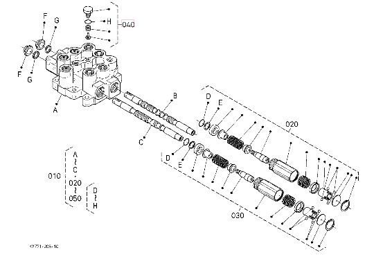

I have a leak on the loader valve for my BX24d. The leak is coming from the caps for the spoolers. My WSM only identifies them as a "plug", and the parts breakdowns that I have seen only identify them my letters (A) and (B). Loader Valve.JPG The leak is from the ends when I use the loader. Both curl and lift functions leak and spew hyrdo oil. HELP!
