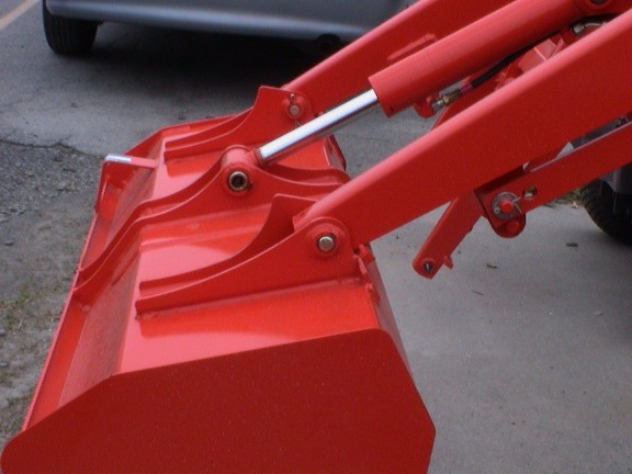

IC Smoke, I suspect that you are a victim of the dump cylinder geometry of the Kubota BX24. When the bucket is fully dumped, the pivot pins and the dump cylinder pins are nearly in-line with each other. This put lots of strain on the pins when the loader tries to self-destruct in order roll the bucket back from the fully dumped position. Take notice of how extensive the bracing of the mounting of that dump cylinder is on the back of your bucket. I attached a photo.

Back on the picture of the bucket rolled forward, you should never be doing anything but dumping with the bucket in that position. If your in the dirt with it like that your going to bust pins, and run a real risk of tweaking the cylinder piston. One of the most common loader failures comes from guys back dragging with the cylinder extended to the max.
/ BX24 breaking loader pins? (bucket:loader arm) #16
Neil is correct. The bucket edge was just above the ground in that photo and was not being used in that position.

If the bucket stops hit the arms "violently" as you say it would be easy to break the pins . The short distance between the stops and the pins would cause a leverage advantage over the pins that would amount to many thousands of pounds . I can't see any reason why the manufacturer would allow the bucket to crowd so far under in the first place (unless it needs that much to dump when the arms are raised) . The angle of the tilt ram is past it's leverage advantage and is such that the ram can't even help with the gentle stopping of the bucket which looks like it nearly free falls before hitting the stops .
