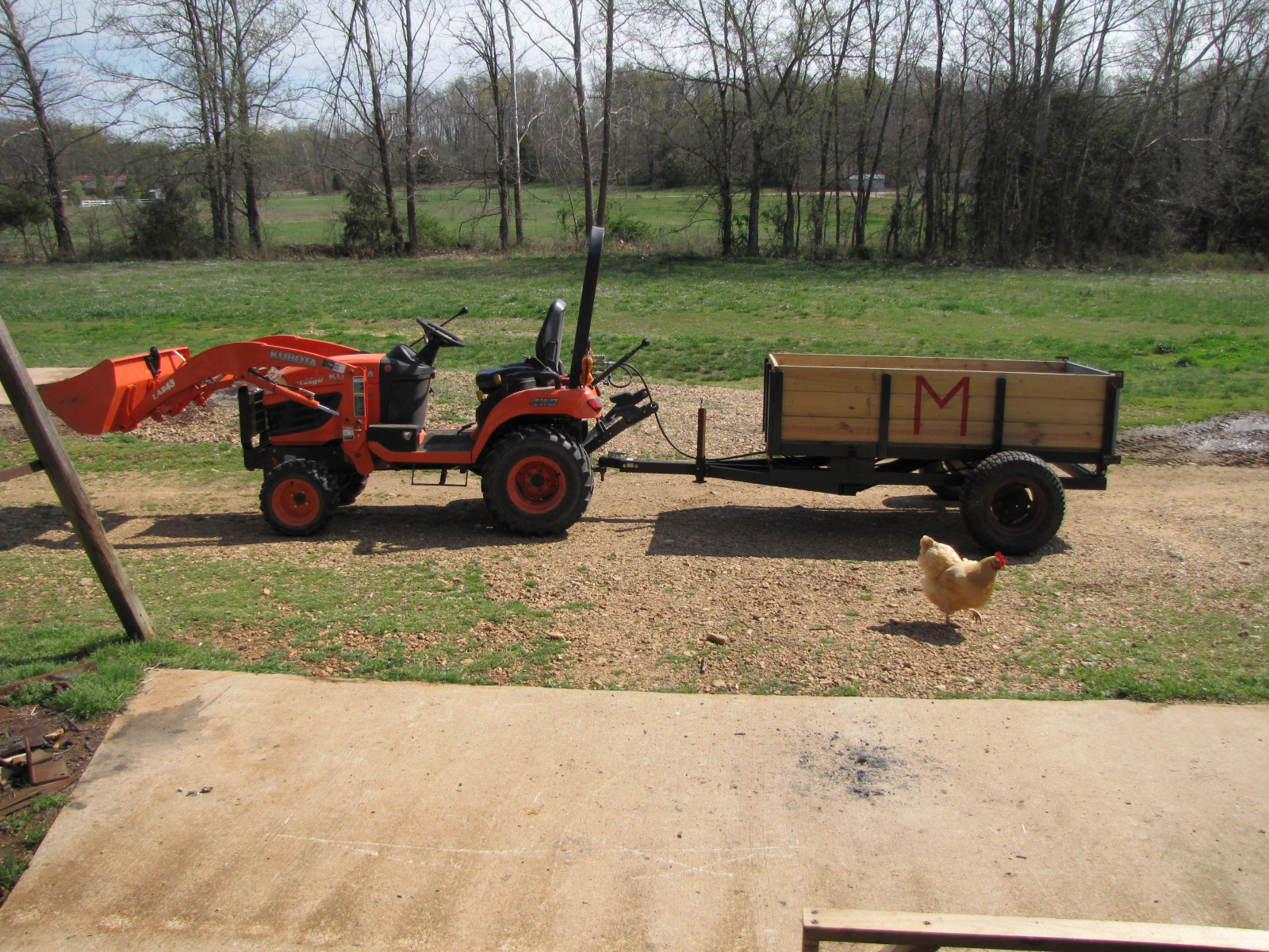

Your can blow up this picture and see how I did my draw bar. It took 2 pieces of angle iron and a piece of flat stock, cost for all of it was maybe $50.00. The other picture is you can see how even the dump trailer is. The upper mounting holes on the tractor was there, all I did was to match the holes. After mounting the angle I just welded the flat stock with the draw bar and holder on.
RickB and the other guy are right .
