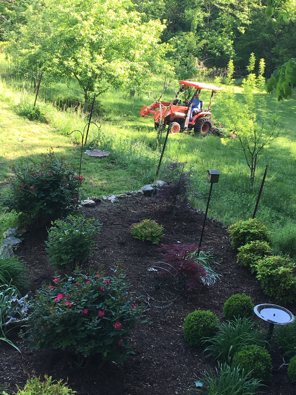

Wife is mowing the yard and lower orchard now with the B26. More acreage, woods, grapple? I would get a little bigger tractor. Fun size and lots safer on the slopes. It replaced a B20 after 23 years. She’s happy, I’m happy. Best return on my investment.
