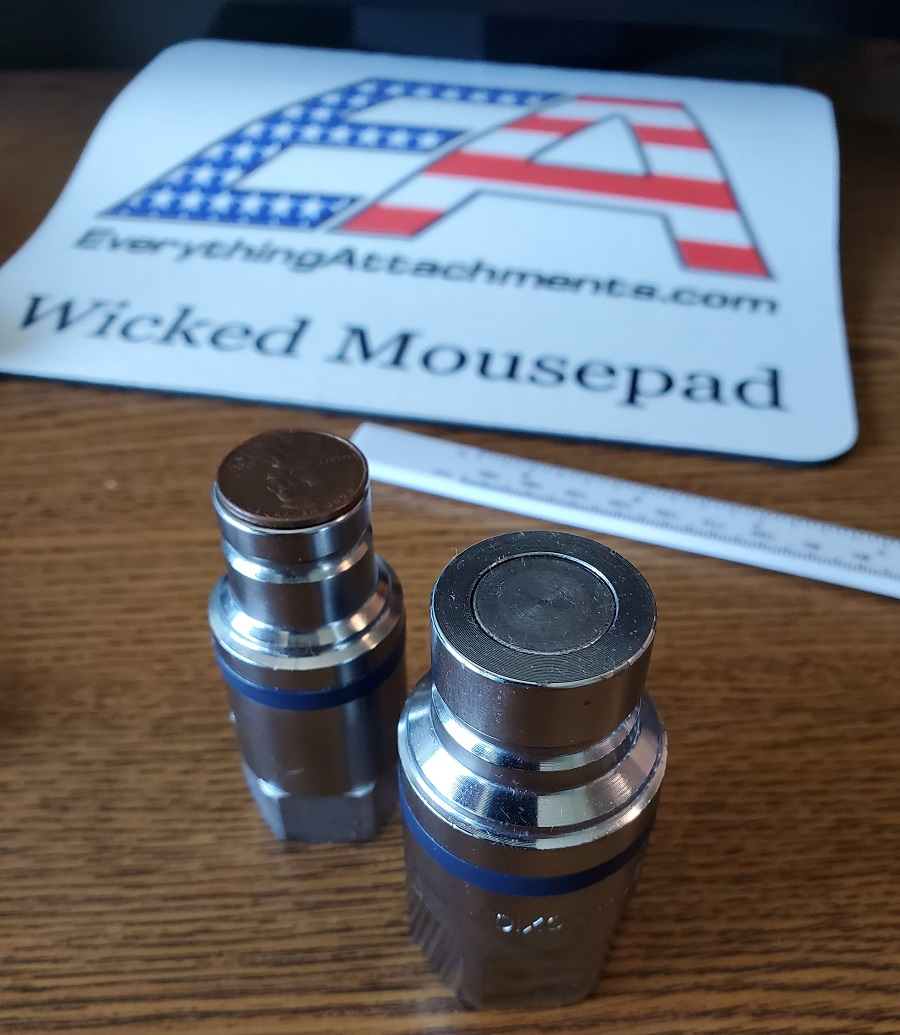

An easy trick I've learned to identify FF coupler size...
If the full face of the male one matches the size of a penny, it is 3/8".
If larger than a penny, 1/2".
