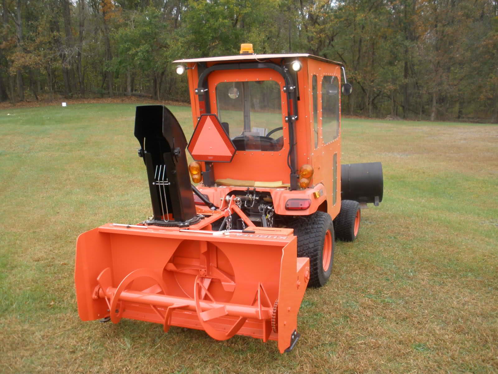

This BX2360 takes care of 10 acres mow 6 of those. It also takes care of 900 feet of drive summer an winter. Snow Blower.jpg
